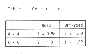

Just the case? if its a built transfer case you should be able to tell by testing the input to output ratio. If its just the case we may have to wait for Jim or Scott for an answer.
gear ratios.jpg (18.42 KiB) Viewed 3320 times

I know the drive shaft input plate, now which of the other two output gears shall I count-The bigger one or the smaller one- or does it matter.
Re: 710 Transfer case numbers
If i understand correctly the 6x6 in road gear is 1:1, so i'd try turning the input shaft in one range than the other looking for that 1:1 input shaft to output shaft ratio. If neither range shows 1:1 i'd think it to be a 710 box. These are guesses on my part however that's the way i'm understanding the manuals.
