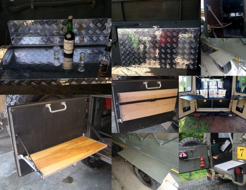

Here is the collection I have so far for tables/shelves - some are not Pinz but idea would still work.

Mine are the two with the yellow stripe in the pic. Where did you find them?
For anyone that wants to know more send me a PM. They work great and were very inexpensive to make.

Do you have a larger version of that one in the lower left? Im curious how that hinge/support is made. That would look good on my other Steyr door.

The lower left table is mine. I posted it in an earlier thread, but something happened to the link so here it is again-
https://plus.google.com/photos/11596512 ... IGn_fXKqgE
The pivot is a bent piece of aluminum with a hole big enough for a delrin bushing and an allen bolt into the birch plywood.

krick3tt wrote:Mine are the two with the yellow stripe in the pic. Where did you find them?
Morris
Interweb :)
I think you either posted them or you emailed me a link to them?
I like where you store the smaller one too!
