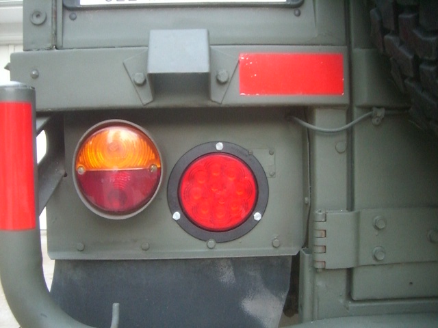

Well, I couldn't bring myself to do it. Mounting the LED inside the reflector
will work, and probably look good, but the reflectors I got were so shiny and
clean that I just polished them up and installed them, with the LED in a hole
beside them. It throws some pretty good light, and still keeps the intrinsic
appearance of the original design.
(I mounted the LED in the center of the old reflectors, and you could barely see
it, other than the difference in color. But the reflectors are so unique to the
Pinzgauer design and you can't get them anymore!)

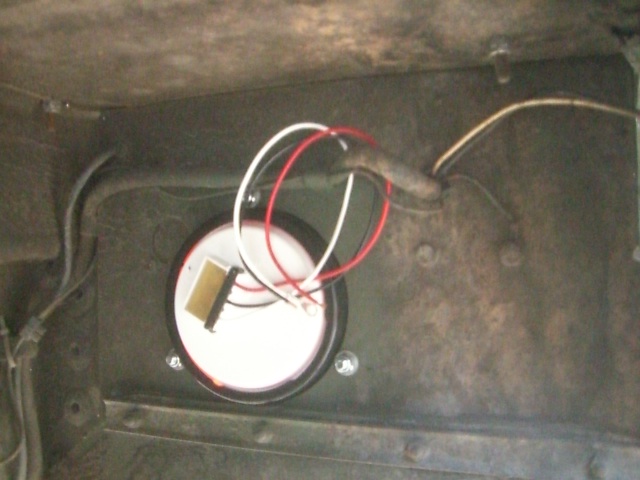

The way I wired them, the LED functions as a brake light and turn signal,
simultaneous to the OEM one.

I used 4 inch LED lights in place of the reflectors.

I like it. So it flashes with the signal and brake, but isn't a running light too right? Have you posted a link to the LED? 24v?
eat, sleep, Pinzgauer
Re: Extra LED turn and brake lights w/ OEM lights

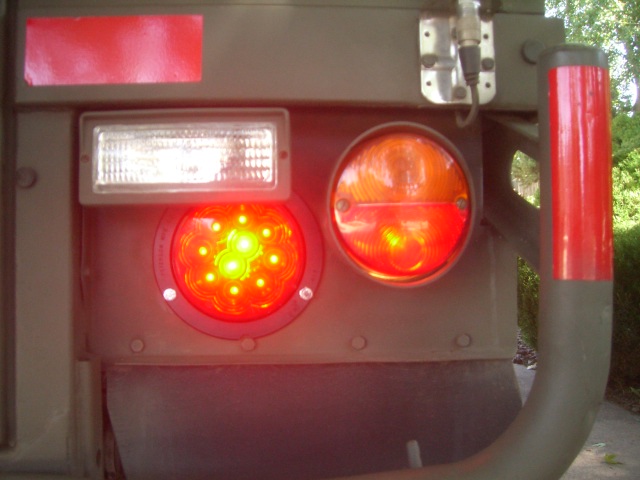

The LED lights are mostly for visibility at night, similar to what a reflector would be. They also work as brake lights and the turn signal is the amber OEM light in the original fixture.
I don't think it's to far in considering the vehicle. If I could find the proper fitting LED light bar, I would have it all the way across the back from side to side.
Got the lights from a place in San Diego called Lighthouse, there is also one here in Denver. The lights are from Grote. Yes 24V. All the LED stuff I get is from Grote. Quality and I
don't worry about them not working. They are sealed against water intrusion. Used the same lights on the rear of my Mog when I had it.
