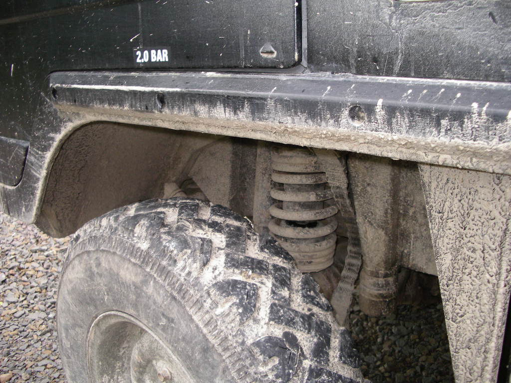

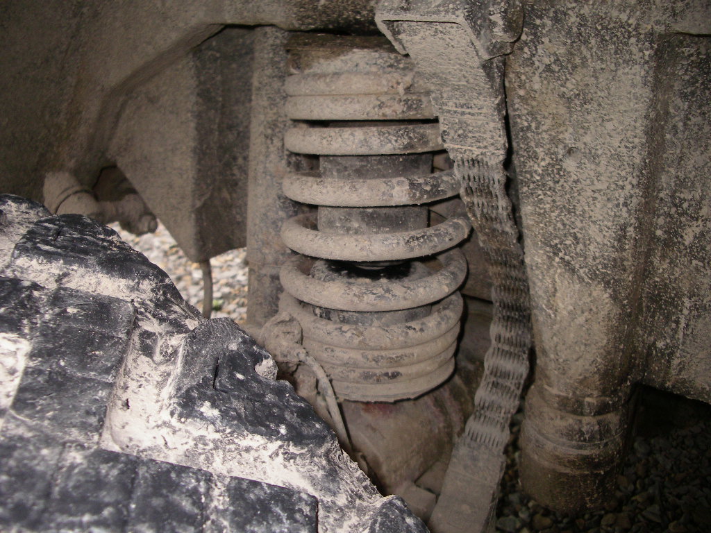

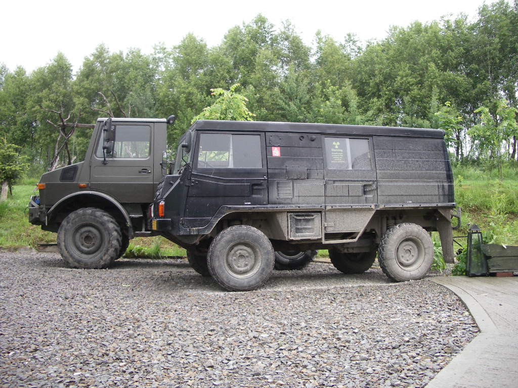

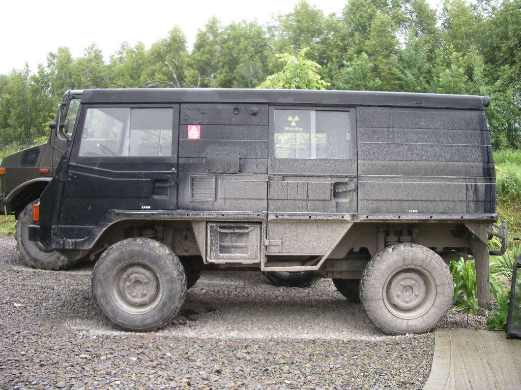

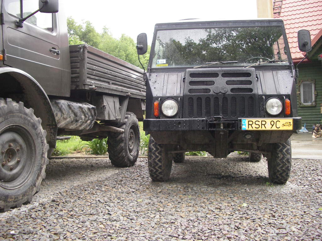

Can anyone give me an opinion...are my front springs compressed? The bump stop has 1 mm gap.....see pics..she seems to sit OK on the flat, but if facing downhill is very nose down and splayed.....The reverse rims fitted by OP don't help that look.

Well, they certainly look tired. Frankly, they don't look much worse than our 710M. Unless you feel you are bottoming out often, or plan to carry a full ton often, I wouldn't worry myself about them much. I doubt that anyone would say you were wasting money if you replaced them, but you could drive another ten years with them as they are, especially if you don't do much with heavy loads (and then most of the weight is on the rear axle anyway...are my front springs compressed?
