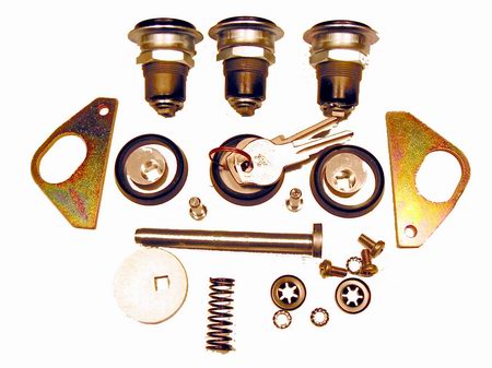

I would like to add front door locks to my 710M for "peace of mind." Obviously the canvas top could be cut or a window smashed, but in most situations during daylight hours this isn't the case. What I'm astounded by is the exorbitant price for door lock its - $468.74 for 3 doors from SAV. There are a few parts in the kit, but none of them are high tech IMO. $100 would be more in line (still excessive). Why the high cost? Are there alternatives other than hasps and padlocks?

The door latches are unique to the Pinz and the lock parts are unique to the latches. I haven't come across an alternative method. We're at the mercy of the European suppliers that set the prices to SAV and EI.
Here's a set on ebay that you may be able to pick up for a bit less: http://www.ebay.com/itm/3-DOOR-LOCK-SET ... 4d22398c7d

Back when I had spark ignition M Pinzes :P , I had looked at the factory lock setup and determined it wasn’t worth going through the hassle of installing them because they could only be locked and unlocked by the key from the exterior. The mechanism rotates a bar behind the latch to block it from retracting. If they failed while locked , you’re pretty much SOL. And with a “M”, only kept a honest person out and if someone wanted in, those locks wouldn’t slow anyone down, just pop the door and create body damage. Only a little more effort with a K
I was thinking of designing a lock that a fail safe or manual interior release could unlock the mechanism, but didn’t spend much time on it and installed a cylinder lock on the glove box instead and didn’t leave anything else of value visible.
The only special tool needed for the glovebox is a double D punch and die to make the cutout in the door ( or plenty of time with a drill and file :wink: ) .

Edzz, that is great! I heard rumors about removing that screw, but was skeptical. I took the door lock apart to see how this could work and it is quite obvious that it was designed to lock in this way. It even allows the door to slam shut when it is already locked, since it only prevents the outside handle from moving.
Those window glass locks are cheap too: less than $10. It's an easy solution to install, but not as easy to use everyday. I'd still like something easier to get back into after it's locked.
I'm getting some parts lasered on Monday that will adapt a cheap cam lock into the 6-tab cutout in the door. My goal is to not need any body modification. I have a good idea for a lock similar to the $400 one that would operate similar to a normal car lock: turn right to lock, left to unlock, and a knob inside to lock and unlock ( and to indicate lock state). It uses a bar that prevents the latch from moving.
But now I'm thinking it would be a better solution to adapt the built in lock (with removing that screw) into my keyed lock. The only difference between my designs being that you could lock the door from the inside then slam it shut.
Not sure which style I prefer. Any opinions?
