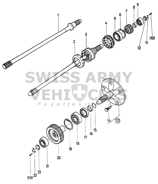

I had something similar occur on the right rear wheel of my '72. Here's a diagram:

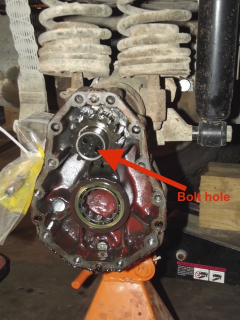

Item #11 (bolt retainer) failed and allowed item #10 (2 bolts) to propel themselves thru the brake backing plate. Gear oil flowed heavily thru the break and into the brake area before exiting similar to yours. Here's a photo of where the bolts were:
Pinz hub pc's.jpg (107.44 KiB) Viewed 9651 times
If you remove the brake drum you'll be able to see if this is what happened on yours. Hopefully you'll find it's just a blown seal. #04-10-17

If the seal (#17) fails, the gear lube will flow out of that weep hole. In theory that is supposed to keep the gear oil from contaminating the brakes.
Paul U. "undysworld" did my repair for me because it was beyond my mechanical talents and required a gear puller I don't have. Hopefully you'll just need the seal and the o-ring (15).

The axle seals are offered in 2 sizes, 55mm or 60mm.
The 55mm spacers can be danged during removal(use a scraper and hammer at the base).
The 60mm spacers are easier to service but can be prone to pitting
So it is wiser to order 15,16, and 17 so the seal matches the spacer the first time :wink:

:evil: Paul you were unfortunately spot on with your diagnosis. After ordering the parts from Sarah just to replace the seal, spacer and O ring I decided to get a jump on the job and pulled the wheel and the brake drum. :shock: Oil inside the lower section of the drum and on the bottom of the shoes. Further inspection revealed some metal pieces and a crack in the brake backing plate up at the top. So, yesterday was a typical Monday!!!!
I read where someone had their backing plate welded/mended. Is this recommended or do I have to drop a couple of hundred bucks on a new backing plate???? I'll dig further into some old posts about this repair to see what else I will need. Paul thanks for the pics and the heads up. Jimm thanks for the input and Andre, I hope I don't have to call you but rest assured if I get in a jam you will be the man to get me out of it.
