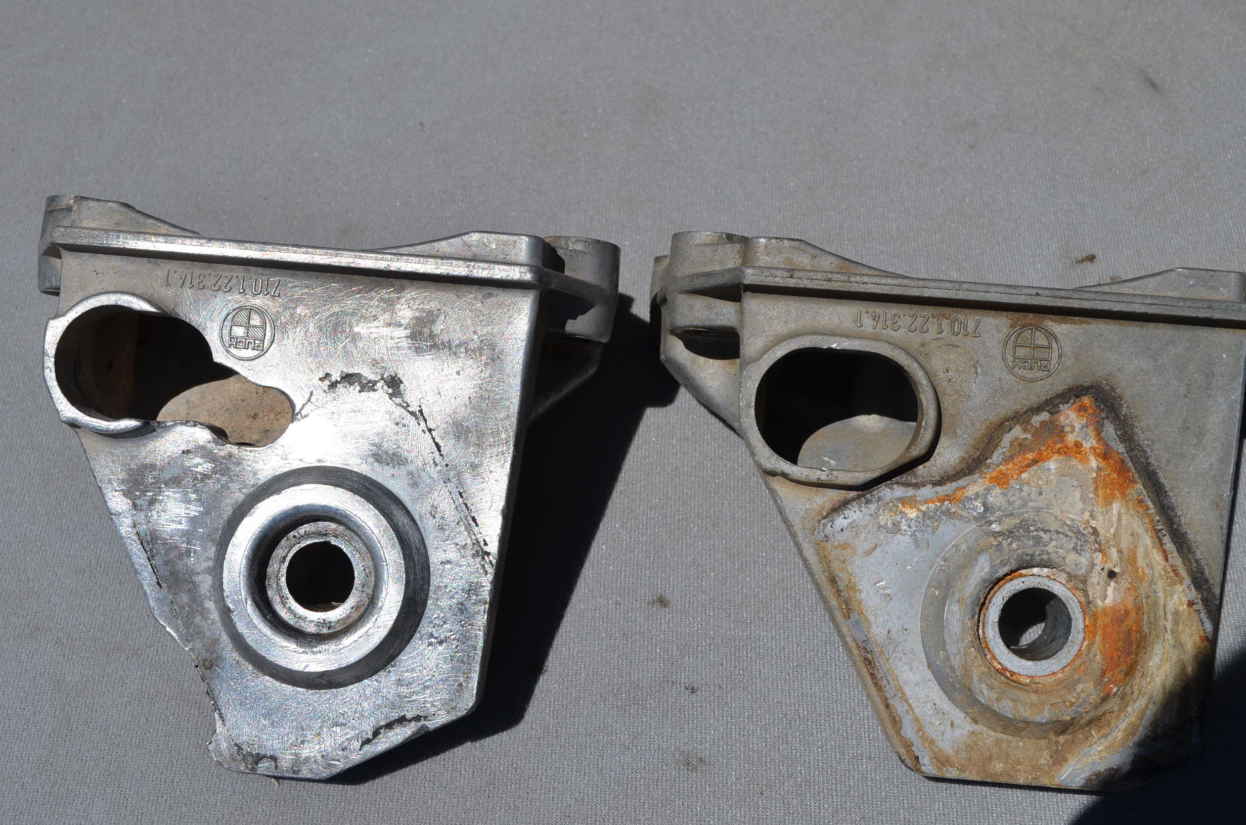

Would not jump to the differential right off the bat. We are seeing some things come through the shop which are lets say interesting. Suggest you get under the truck and check transmission mounts, engine mounts. Just looking at them might not be enough especially with motor mounts. The weight of the motor can hide a cracked/separated rubber in the motor mounts.
Those transmission mounts do wear. We have seen some interesting "fixes". Should not look like this one.
Scott

ExpeditionImports
Posts: 436
Location: Vallejo, CA

Post by ExpeditionImports »
This one was not much better.

ExpeditionImports
Posts: 436
Here is what the mount looked like when all the bolts and "fixes" were removed.
