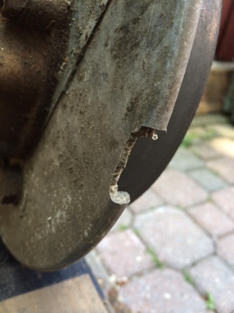

Any reason to replace or just leave it as is?
Either PO or I hit a rock at some point!

It will be ok, I've seen bigger missing lip sections with no problems.

I have a similar problem with mine. JB Weld is great for building up old castings.

Use an Epoxy resin to remake the lip to help keep the rubbish out when you go off road. Not actually required for the wheel or brake to work, but definitely helps keep the brake shoes clean!

Thx will just patch it up

Structural integrity is not compromised, and I don't think any more dirt will get into the brake drum area. A JB Weld patch would work.

Here is mine after my front wheel fell off.
The price of a new backing plate was such that it was not worth replacing so I used epoxy steel to repair - the first one came off when I put the brake drum back on but my second go worked fine and is still there.
The brake drum which I did replace, but actually worked fine.
