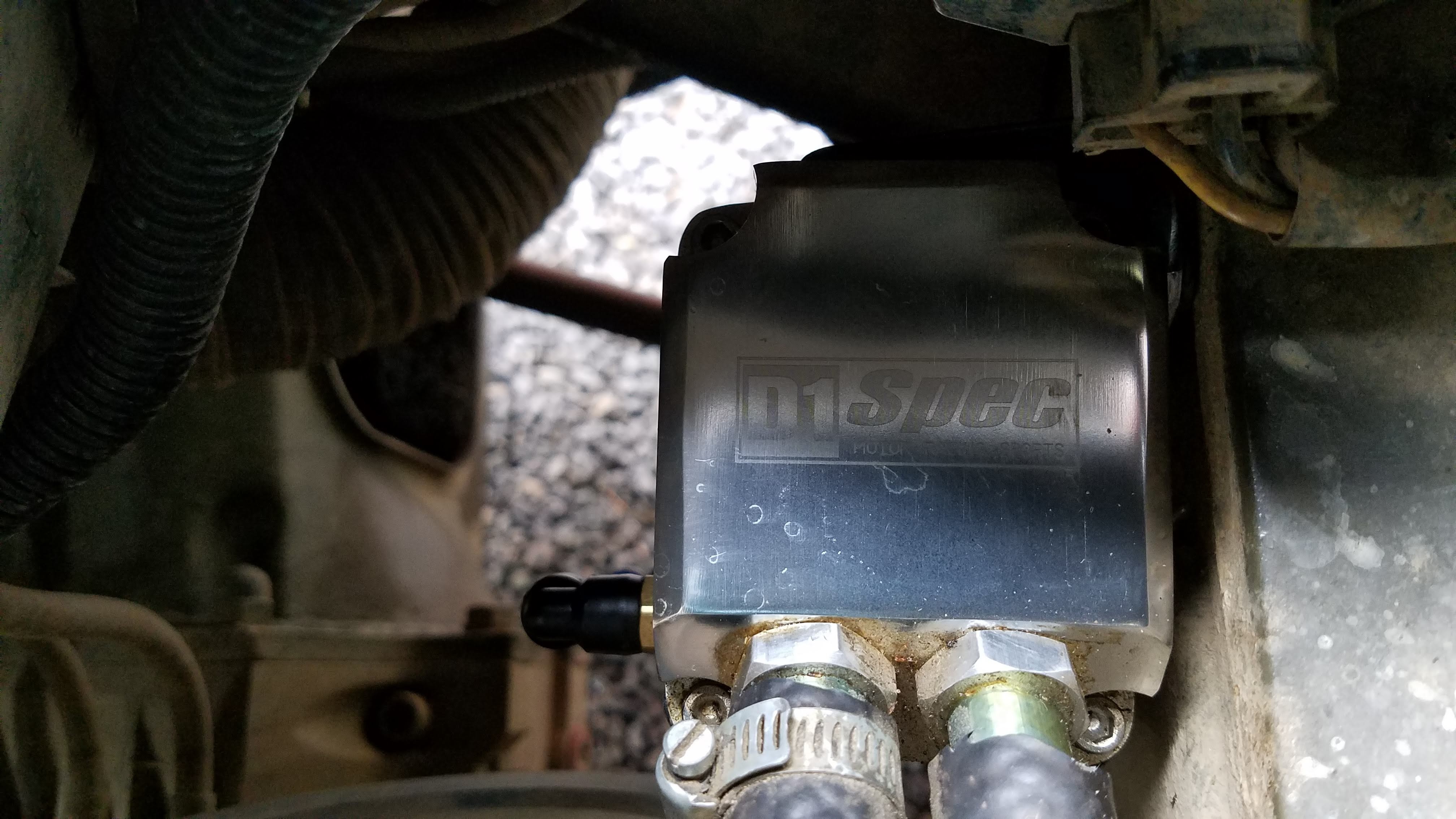

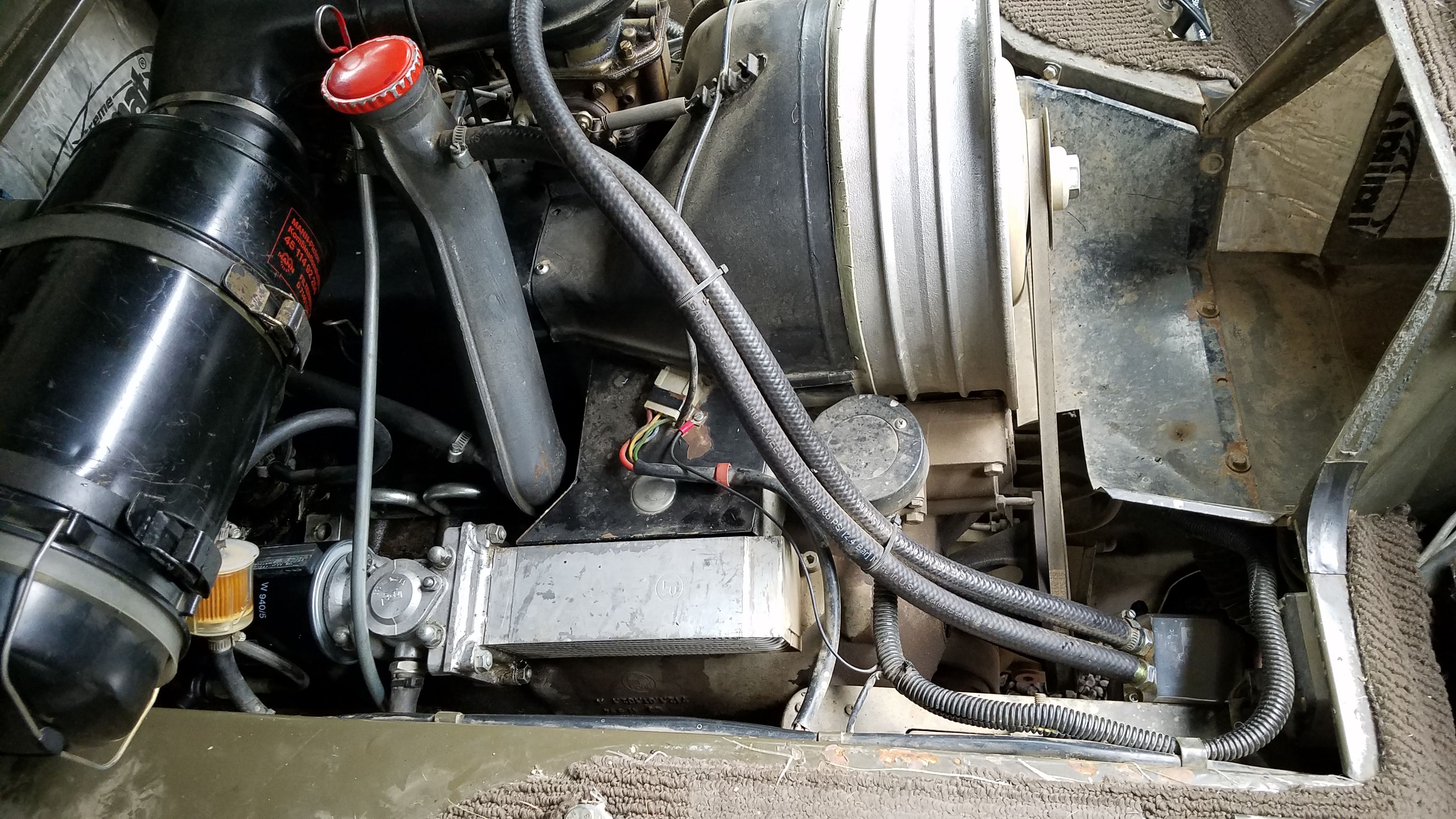

Here's the catch can I installed in the line between oil filler and air intake hood. There hasn't been much accumulation in it until I checked it yesterday and it was 2/3 full of a fuel/water/sludge mixture. I'm pretty sure this is the same sludge that occurs by condensation within the crankcase. Since the last few months have only seen short drives in cold weather the condensation makes sense. It wasn't the oil I was expecting to see, but at least its not in the engine.

I found this one on ebay with a search for 'square oil catch can' or breather box. There are hundreds of variations. The quality is OK. I had to do a little touch up with a file at the fittings and buy better hoses. I decided to mount this one low, but you might want to look at installing an Empi VW breather box mounted up high on the firewall near the aircleaner.
