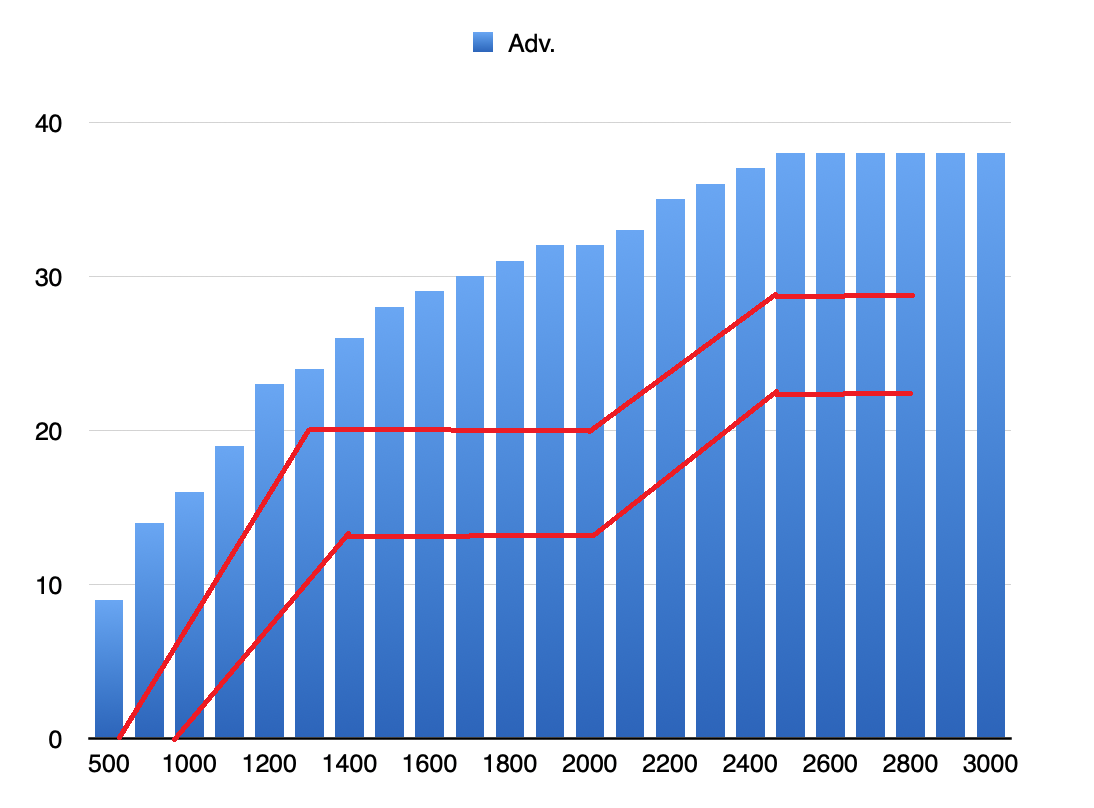

For what it's worth, attached is my advance curve for a 710 EFI. This would
be applicable to low MAP pressure (less vacuum, heavy load). Although the
MAP at low load is only an additional 4 degrees of advance and would be
applicable at Idle and low load situations. The contribution to advance due
to MAP will drop to 0 at moderate to high loads.
This curve represents characterizing the engine on a Dyno then years of
tweaking thereafter -- monitoring AFR, port temperatures, and performance.
As you can see, advance is more progressive up to 1500 RPM then flattens out.
I do run 91 High Octane. In Europe, since on the RON system, this would be
closer to a 100 number. Point is my advance may seem aggressive but not in
the context of High Octane.
IMHO, I'd get some experience with your motor -- as is -- before moving away
from the stock setup in spite of the curve you have. Giving different grades of
fuel a try.

Interesting. It's good to see real life data.
Below I've overlayed the recommended stock Pinz advance range, just out of curiosity.
I'm planning to go step by step indeed.
I'll probably jump in with the Speeduino, adding a toothed wheel on my crankpulley,
this way i can run stock with my current mechanical advance, and use Speeduino for data acquisition only and see if my crank trigger signal is steady.
Then I should be able to compare the output from Speeduino with the recommended stock Pinz advance and match it,
then i can switch to Speeduino to control my advance, starting with idle check, just a simple "static" map that will keep my advance as-is,
then when i'm confident with what i see and hear, i can slowly integrate other sensors one by one, MAP first, and impact my advance.
I still think i can add a knock sensor, people have done it on old Porsche and VW engines, at least I'll try, for monitoring.
