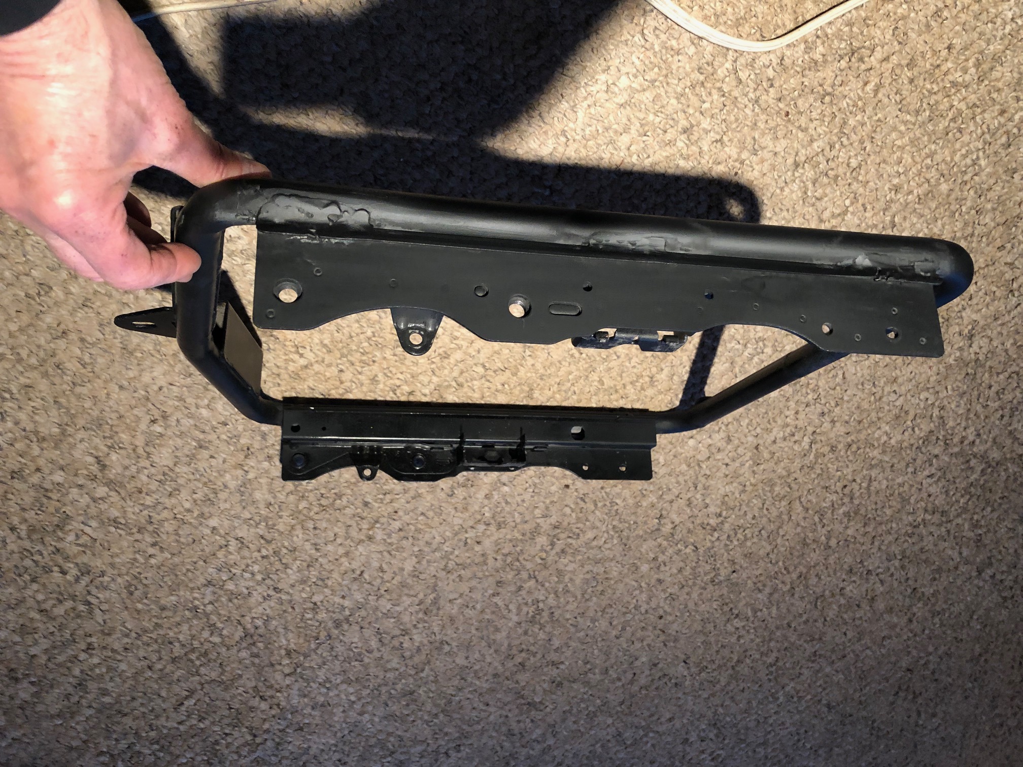

Well here's my Smart Car Seat frame -- passenger side.
Top portion of slider retained and welded to the bottom portion
of the Pinz seat frame. I ended up tack welding the members
in place then torch Brazing them inplace. My MIG is a complete
POS, but once tacked you can remove the seat bottom and torch
away. Time to cave and get a decent MIG.

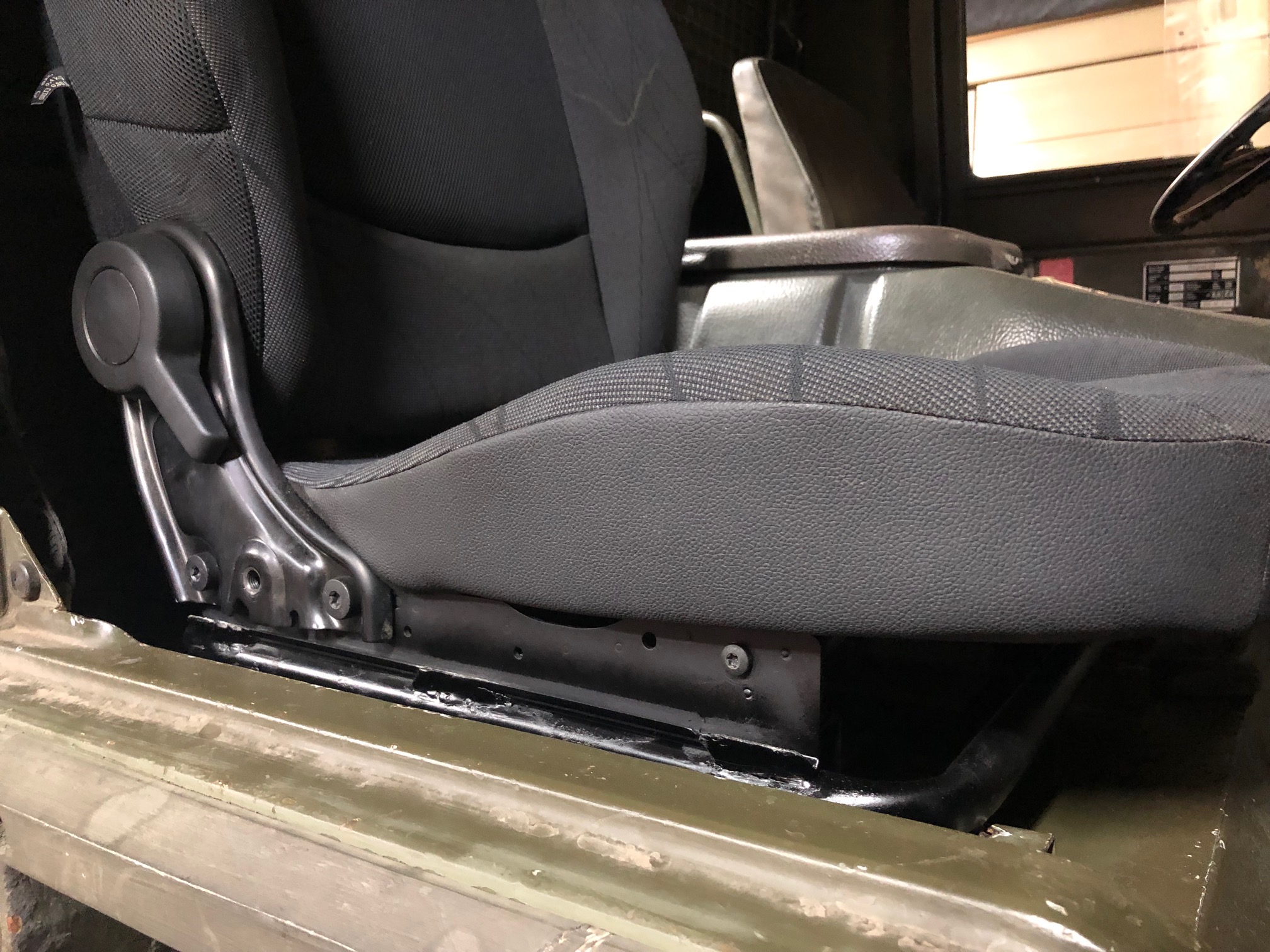

Re: Smart Car Seats
Passenger seat installed. As you can see using the upper portion of the Slider
as a base to weld to the Pinz bottom frame does not raise the seat significantly.
What's nice about using this member is that the seat is easily removed from the
frame. I also chose to swap the position of the seats; Driver to Passenger
and visa versa, placing the seat recline control outboard making it easier to
adjust recline when removing the seats.

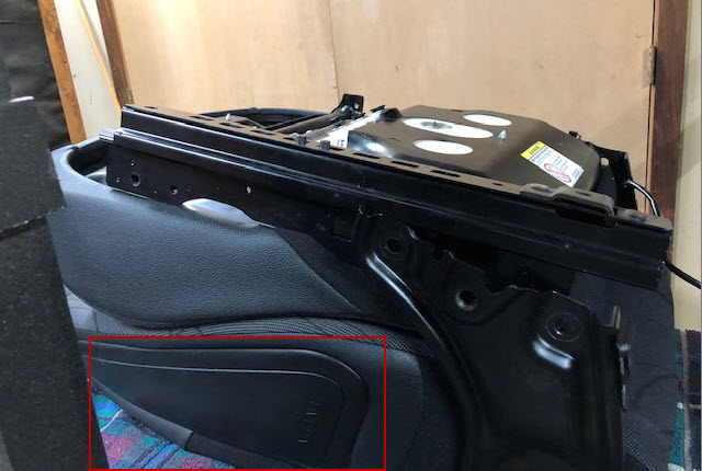

Re: Smart Car Seats
What did you do with the side air bag?
Re: Smart Car Seats
Oh
Hmmm, well I didn't know there was one.
Didn't see any indication of something on the side of the seat.
Can you send me a PIX of it's location. Wouldn't want that
to go off randomly.
to go off randomly.
Re: Smart Car Seats
Side of the seats - ABS logo
If you don't mind, can you let me know... mine are still in there too
There was a post online I found last summer on how to remove but it was some pay for the info link I was not about to do

Re: Smart Car Seats
Well Dah
says Airbag right on that plastic side panel -- I have them too.
I suppose this is another good reason to swap the seat positions. If for some
reason the activator decided to go off the bag would have a larger space to
expand to. Dono how I didn't notice this
Found these two links, one does require an annual fee of £10 -- Evilution seems
to be the place to go for these Fortwo's.
https://www.evilution.co.uk/interior/airbag_removal.htm
Here's what the unit looks like, found this on eBay.
http://vi.raptor.ebaydesc.com/ws/eBayIS ... 8000&ver=0
I don't think I am going to touch this, unless a well defined procedure surfaces.

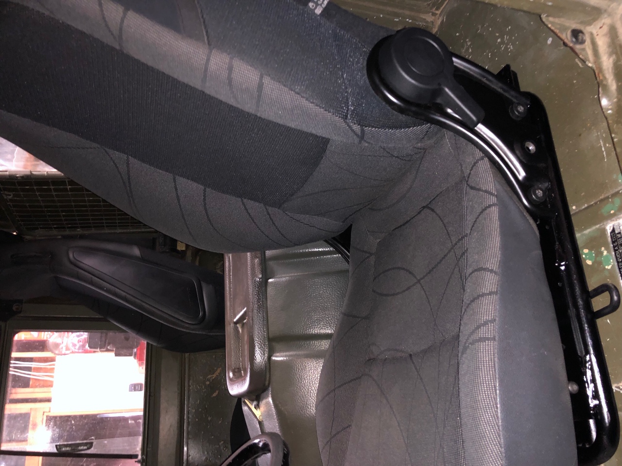

Re: Smart Car Seats
Final install. The one additional minor recommendation I would make
w.r.t. the drivers seat frame, is to cut approximately 1/2" off the bottom
of the Upper portion of the Smart Car seat rail. This will result in both
seats perched exactly at the same height -- these are unusually high seat backs.
The reason the Drivers side Pinz frame is higher is due to the frame sitting
on a slider mechanism raising the overall by about 1/2". I wanted both the
seat and headrest as low as possible.

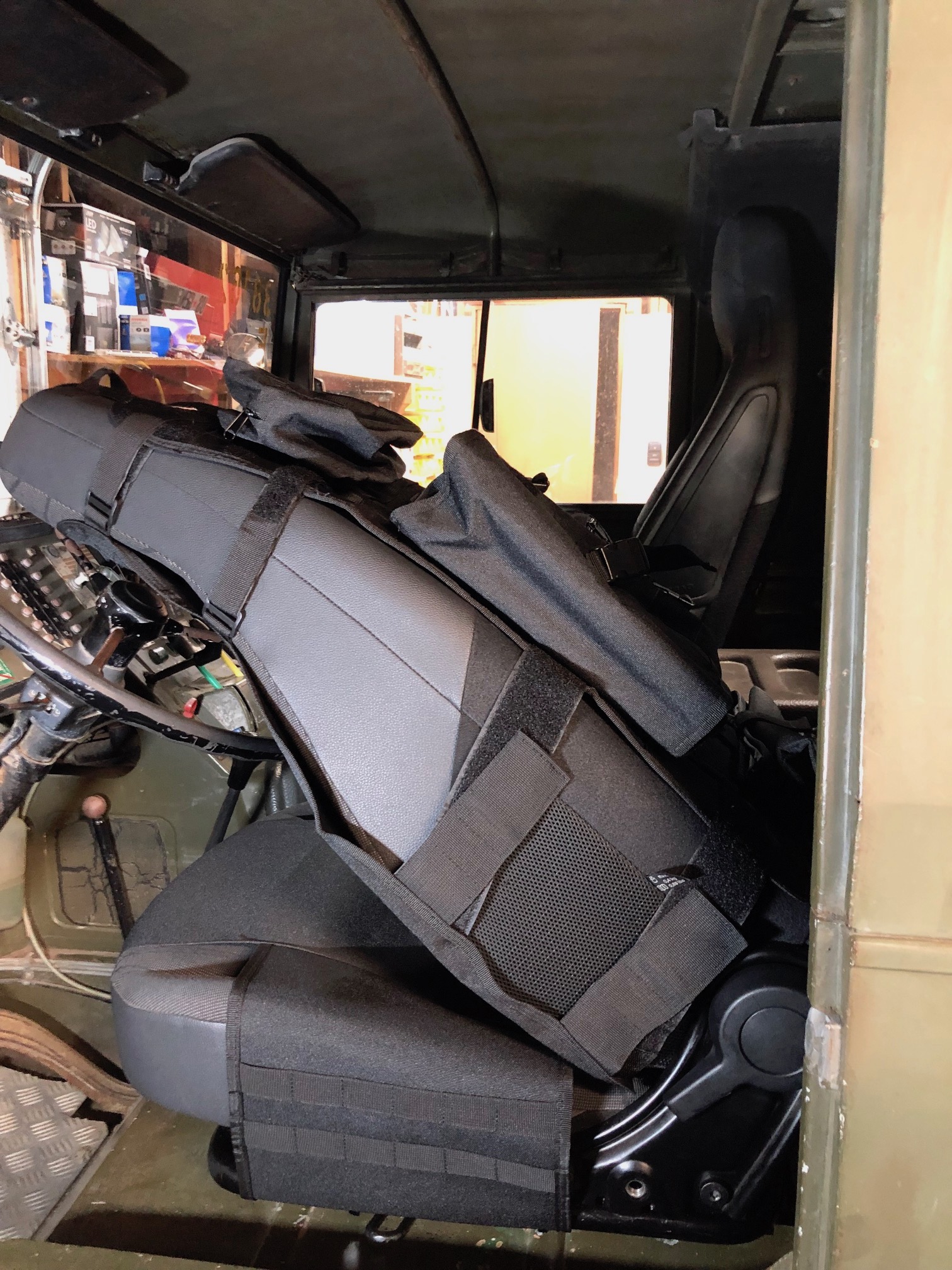

Re: Smart Car Seats
Final tweak
I sprung for a MOLLE/PALS seat cover from Rugged Ridge.
Was a bit of a gamble as these Smart Car seats are narrow and high back.
After market products like this from Rugged and Smittybilt typically
target the Jeep market. I have a set of Smitty covers in my 710 and I
knew they would be too wide and stout for these Smart seats. Good news
is that the Rugged Ridge product is definitely cut narrower and a bit longer
so the fit is decent. Very handy for putting FirstAid, Tire care, lighting,
etc etc etc in these seat back pockets.
