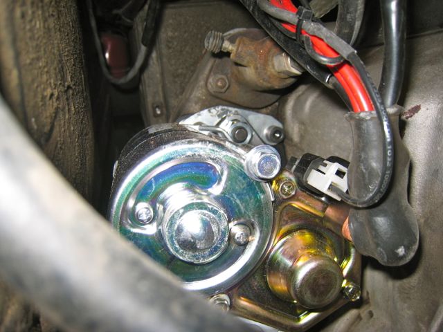

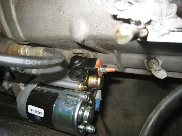

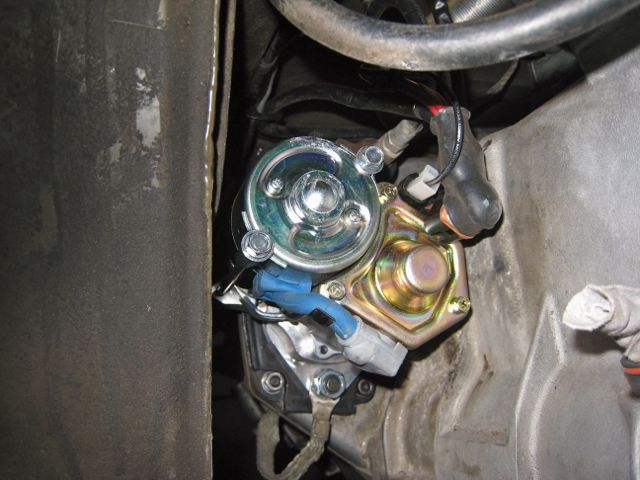

I just installed EI's Pinz starter and can't say enough good things about it. It spins the engine faster which in turn makes it catch quicker.
Installation wasn't too bad - actually taking the old one out was a bit tough but putting in the new one was easy. I went ahead and replaced the rubber mount at the same time since it was showing a bit of age. If you also decide to add the steel retainer bracket (yes, it's overkill) you'll also need a couple of new bolts as shown in the parts book.

Thanks Paul,
Last time I looked at mine (I think) the connections were held on with nuts on shafts. Your pics look to be a bit different.
Were there some modifications to be made to the connections to make it work?
Re: Starter question
There is a main stud with a nut hidden under that rubber boot. I had to loosen up the wiring harness from under one of the retaining clips so it would reach the starter but no mods necessary. The new starter comes with a short length of wire with a special plug on the end to connect to the starter. The other end of the wire just needs to be spliced to the existing black wire that went to the old starter solenoid.
