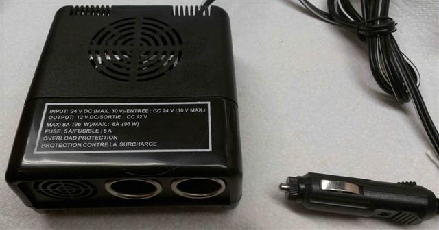

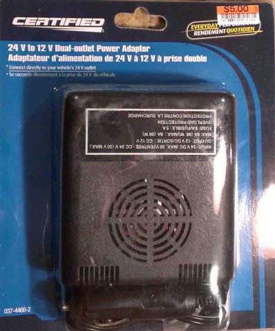

Found 24 volt to 12 volt converters for $5 at my local Big Lots store. For five bucks I had to give it a try. So here is my take on it.
1. why is it supplied with a cigar lighter plug? Are any vehicles equipped with 24v lighter outlets?
2. the fuse is in the lighter plug.

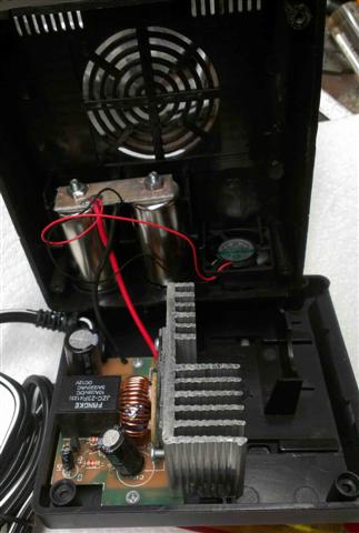

3. it has a small cooling fan, it’s always on when the units powered up and it’s quite loud, did I mention it’s noisy?
So what to do?
1. install fuse adapter so unit can be hard wired to my truck
2. Investigate the use of a larger quieter cooling fan or possibly a larger heat sink
3. go back to Big Lots and buy a few more
What the hay for five dollars I can dedicate one for the GPS, one for my electric vest, one for well you gets the idea.
One of my biggest questions is what the heck is Big Lots stocking 24 to 12 converters for?

If you are only going to use it for smaller loads (such as a radio) that draws only an amp or two at 12vdc, you can probably just disconnect the fan and it will work OK. You might try it with the case open first and feel the heatsink - if you can't keep your hand on it then its too hot.
A bigger heatsink would help but is a lot of work probably. Some of those little fans can be loud - but often its the way its mounting and the grill right in front of it - try pulling out the fan from the housing and seeing how loud it is.
