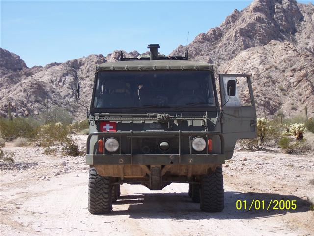

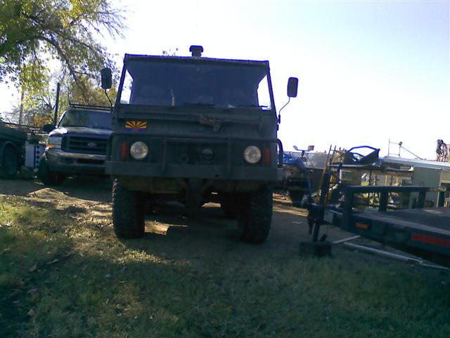

Front View with sagging springs and after with Mark/Stan's modification.
front view (Small).jpg (50.79 KiB) Viewed 8226 times
100_3307 (Small).JPG (66.33 KiB) Viewed 8226 times

I asume the 1st photo is w/ the new springs and the lower 2nd photo is before the change...?
Re: Spring ???'s
Yep, does not show up well on the camera photo with the shadows. I will try to get a better one in the next day or two once things calm down a bit. It actually raised my front bumper height 3.5".
