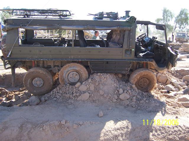

I made this roof rack with a ladder which allows me to place it anywhere on the rack to access items up top. the rack, ladder and supports came in under 70#'s all powder coated up. The lighter weight allowed for more storage with less tippy feeling then the other heavier options I saw. I have added slats of wood that can be layed out in the rack to make the rack a nice sleeping platform. when the slats are bundled up they only measure 5 1/2 X 6 and run the length of the rack. Very happy with this setup. I know Tim knocked off my setup and made a few and even some with lots of modifications to fit the customers request. The idea was to keep it light because as we all know the 710's don't need any more weight up in the air.
