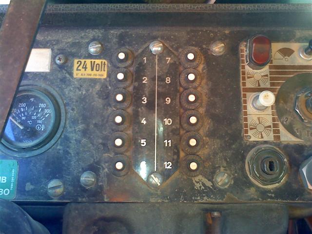

I spent the time and changed all my breakers to the marine style. Takes a little longer but you don't have to keep going in and changing breakers. Living in the south west the heat would set them off every day especially in the summer. Now there is no problem with the breakers, oh and the cost of all 12 was less then the cost of just one. At the time I did this there were Unimog breakers floating around being sold as Pinzgauer breakers (they are different sizes).

How does the conversion look?
My Haflinger has half the breakers failing.. and going to the marine alternative looks promising.
Re: circuit breaker replacement
My truck has a little trail dust on it but you can see what the breakers look like. I have had them in for better then 8 years and have had no related issues.
If I remember correctly I got these from Sea Choice at $5 a piece.
