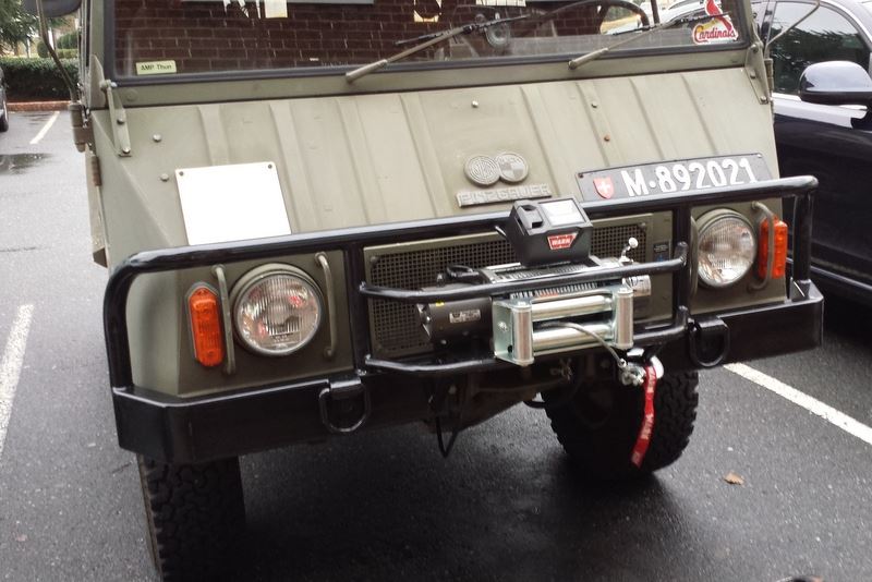

First, a big shout out to Andre @ Fat Fabrications for a beautiful front bumper :) It arrived today via UPS Freight, and was a snap to install.
However, I'm wondering what most folks do for wiring... I have a WARN XD9000 mounted right now, but obviously the cables aren't long enough to reach the battery box. Is the proper approach to extend the cable and go all the way to the battery ? In terms of cable routing, I could easily pull it into the cab from the drain holes in the drivers floorboard, but I worry about chafing on the cutout. Thoughts? In the picture, you can see I've just fished them loosely into the cab.

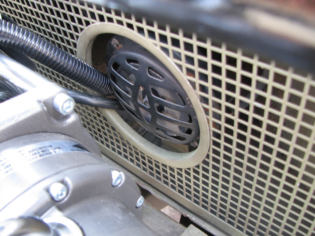

Easy as pie! No drilling required. We routed the cables through the front grill (there is plenty of loose area around the horn's cutout) and zip-tied in the tunnel. One lead to the starter --- (total beoytch to access); the ground is on the solenoid clamp. Works like a dream.

Without taking it all apart again for pictures, here's the skinny:
0) Disconnect the battery
1) remove the seats. A single wing-nut behind each seat is all it takes. Remove the wing-nut and tilt the seat forward -- it'll pop right out.
2) Unscrew the 1/4-turn brackets which hold the engine cover in place. These take just a simple 1/4 turn of a flat blade screw driver, and they release. There is one on each side of the plastic engine cover.
3) The engine cover will now just lift right out of the cab.
4) Fish the cables through the horn hole. Mine got stuck a few times on the nasty foam in the tube, but they came out just fine. Route them toward the passenger side of the cab.
5) Using zip-ties, make sure they are held a safe distance from the fan and fan-belt.
6) The solenoid is mounted in the front-right area. Looks like a can of Diet Coke. Remove the single nut on its chassis clamp, and attach to the winch ground wire. Snug it nice and tight.
7) Shrink your hands down to the size of a 9 year old girl.
8) Repeat step #7
9) The starter is on the rear-right of the engine, fairly deep. I found that loosening the air box allowed better access -- and if I wasn't so lazy, I probably would have removed the filter housing altogether for much better access to the starter.
10) The starter has a rubber cap on the hot connection. Peel it back and using the tiny hands mentioned in #7, attached the winch's red wire. Honestly, this might be easier by gaining access from below. There is a mudguard between the fuel tank and RF wheel that might give perfect access. Once again, I didn't want to mess with it -- but in retrospect, it might make access much much easier. Once re-attached, put the rubber boot back.
All done.

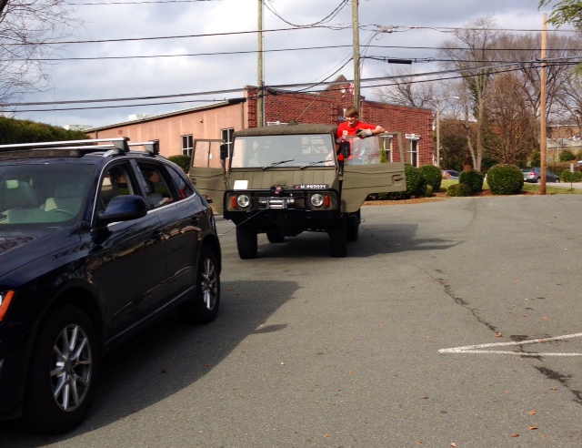

(My colleague, Aaron, decided we needed to properly stretch the cable before real-world use. He took the Pinzgauer this morning and dragged his Audi SUV the full length of the cable, up a slight incline hill at the office)
