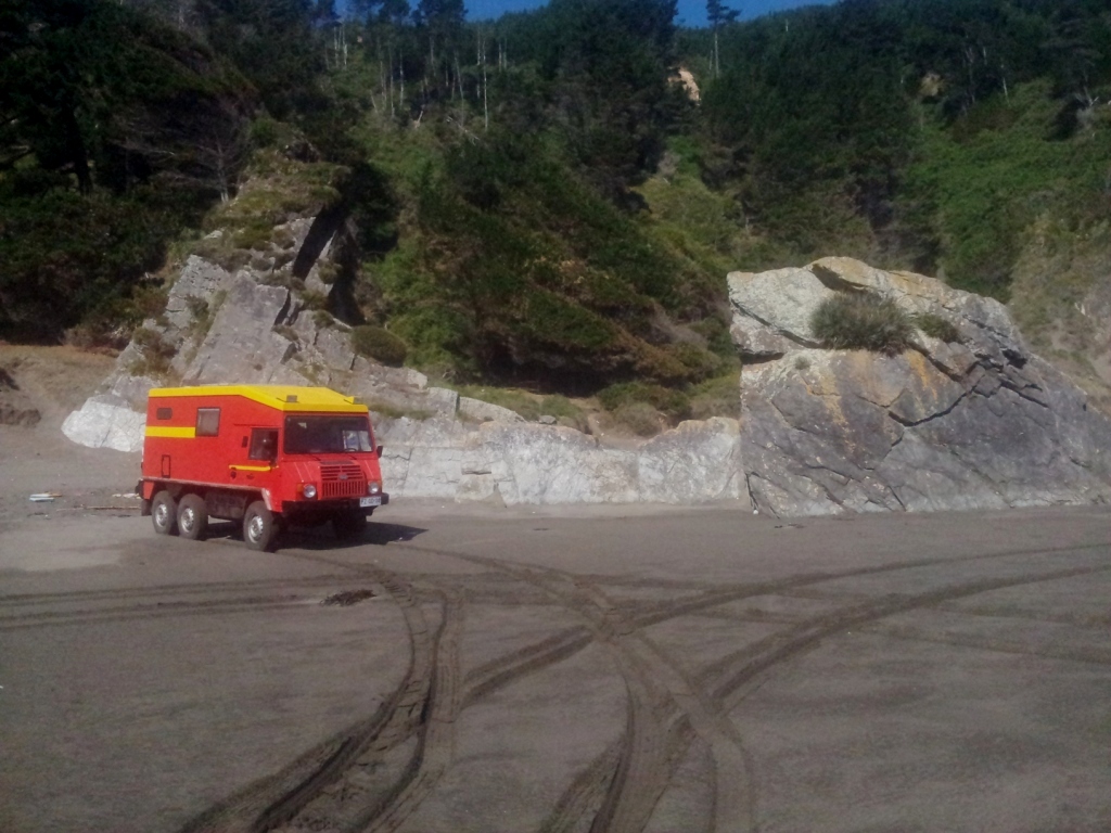

Hi, just made the first longer trip on my 718.
Crusing speed 85-90 km/hr. nice sound for the children to sleep, they could not stand more tan 30 min until they felt asleep, also could not hear my wife complaining about I don´t knopw what jejeje!
Drove about 30 km and checked temp on all transmission including wheels, warm but not hot. Gaining confidence drove 110 km more and as we arrived on destination felt both front wheels hot and the rear 4 were just warm. Levels are ok on all wheels. (Valvoline AGMA 5 ISO VG 220 mineral oil)
later driving on sand I could not get the 3rd axle to connect so I was just able to use 4wd... front and middle axle. Light on the switch turns green, also tried connecting the low speed on the transfer case, but again no traction on rear axle...
Any sugestion to diagnose the temp on the fron wheels (brakes are ok) and third axle not connecting?
Greetings.

- 2014-03-01 16.04.20b.jpg (354.74 KiB) Viewed 12955 times
Re: Wheel drive oil replacement
The 718 (and 712) centre and rear differential are permanently connected together so the vehicle is always operating as a 6X4.......only the front axle can be independently connected (disconnected) by the driver to give 6X6.later driving on sand I could not get the 3rd axle to connect so I was just able to use 4wd... front and middle axle. Light on the switch turns green, also tried connecting the low speed on the transfer case, but again no traction on rear axle...
With the diff locks however, both the centre and the rear lock at the same time by the one switch (rear diff lock) whilst the front diff lock switch only controls the front diff.
Given your question I'm a little confused as to why you believe the rear axle is not connected.
If you’re sure the rear axle is not connected then it’s a major fault, probably a broken drive shaft or connector……or do you mean the rear axle differential lock is not operating? There is only one light on the switch to indicate both locks are on.
If the rear axle lock is not operating it could be a problem with the vacuum actuator or the diff-lock assembly itself ...... the actuator is easily accessable, the lock assembly less so, however, at least the rear diff-lock assembly is the easiest of all three to reach without major disassembly.
Thanks for the answer... but wow
Yesterday lifted both center and rear axles and the rear one is free...
checked the lock and it works on both axles. Unlocked both center wheels turn as they should when turned manually (different direction). On the rear axle both wheels turn freely, independendent from each other when unlocked, as I lock the differential both turn connected the same direction, but has no interaction with the center axle...
also by driving on sand the rear axle has no traction, neither by pushing switch allrad or the low speed lever.
Thanke for the help.
It sounds like you have a broken axle shaft or pinion. Middle and rear axle should react the same.
