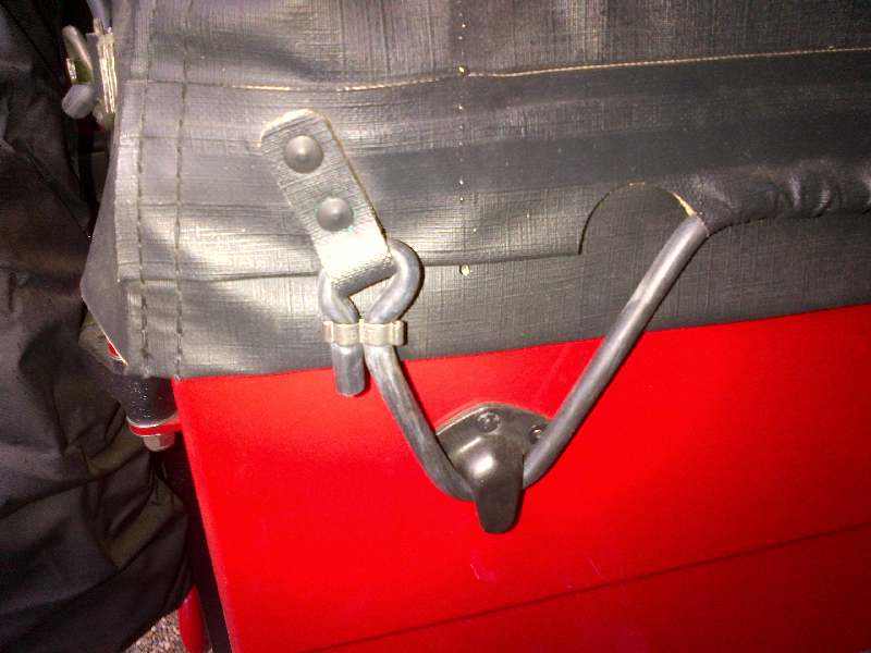

mopar
Posts: 451
Location: Metrowest MA
Re: Crimping Rubber rope for the top.
Post by mopar »
Some pictures of the crimps for future reference as I did not have and of these clamps on my rig to go by.
1974 712M AKA the Banana
1987 718M Now Sold
1975 Volvo TGB1111 Now Sold
1963 404S Now Sold
Just for archive: how did you end up crimping?
Buy the tool, Channel Locks or did you use the tile nippers?
Crimps look good!
mopar
Posts: 451
Post by mopar »
I used a pair of pincer pliers from Lowes crimped the ends first and then the middle. I dulled the plier ends up a little on the sander first so I wouldn't cut through the clamps.
