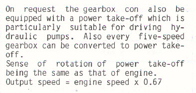

Re: Pro
The repair manual indicates there is a spot to put one on the transmission. The hole that the mounting bracket covers looks like the place I had PTOs on my Dodges. I am having a hard time figuring any other reason for a hole there

Re: Pro
The gearbox they refer to is the transfer case. There is not enough space to mount on the trans. To operate the PTO if equipped, you would put transfer case in neutral and control PTO output speed by transmission gear selection:shock:
This is a common practice on heavy tractors and Mil spec trucks.
As a side note, I have never seen or heard of anyone having one and believe it was never fully realized on production units.

Another interesting tip. I contacted some fellows in Austria that claim they are "successor organization of the Steyr-Daimler-Puch customer service department". I asked them about the PTO and here is their reply:
Hello
Yes you are right the PTO is mounted on the gearbox
This PTO was installed in the Pinzgauer 712 - produced for the army in Venezuela
We don’t have any parts on stock
Maybe you will ask somebody in Venezuela
PS: Our supplier was ZF
