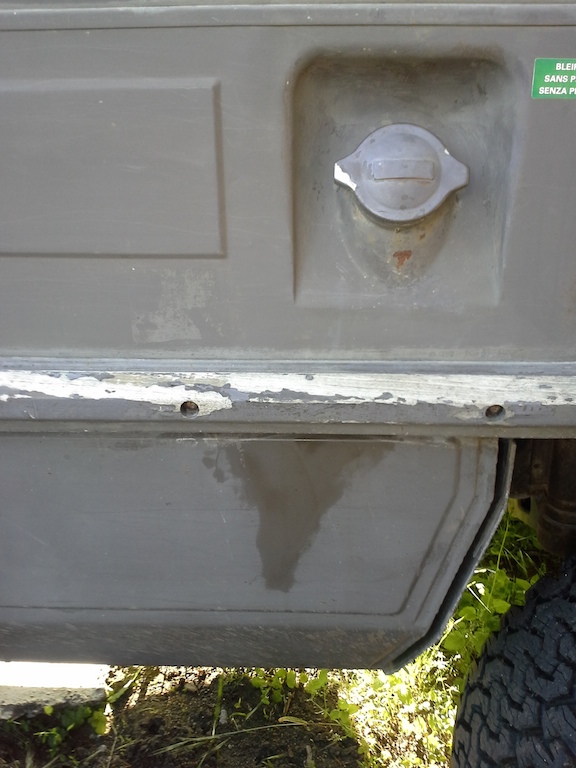

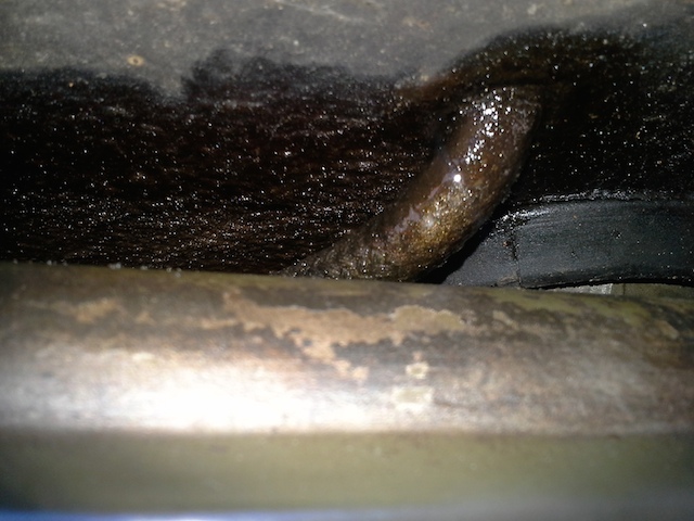

Truck is (and was) running fine, however this ooze trail appeared after sitting for a week in moderately (85F) warm weather. I haven't had a chance to get into super research mode, and am still figuring out the truck as a whole in general, but I'm going to inexpertly hypothesize old hoses? Seems to be too much for general weeping. What I can see is a braided hose, covered (but not dripping) in a lighter color fluid. It doesn't smell like gasoline. The hose sits on top of the gas tank and runs aft, but where to I have yet to determine as I haven't pulled anything out yet.
Does anyone have an prior knowledge or insight with this particular issue?

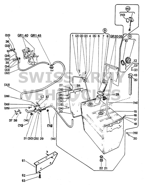

If you take a look behind the passenger seat at the gas tank fill pipe, you'll see a smaller metal pipe that comes off the rear of the fill pipe and goes down thru the floor. This is a vent pipe for the tank. The pipe connects to that hose covered in goo and the hose than goes back into the tank.
That hose is #14 on the following diagram:
Most likely that hose is old and is weeping gas slowly. The fumes probably just evaporated.

If you drop the tank replace the two cork gaskets #5 in the drawing at the tanks mating surface for the fuel pickup tube and the fuel level sending unit. That's where mine was leaking and exhibiting the same appearance, I replaced all the fuel line going to the tank at the same time. The large fuel fill tube was fine on mine.
