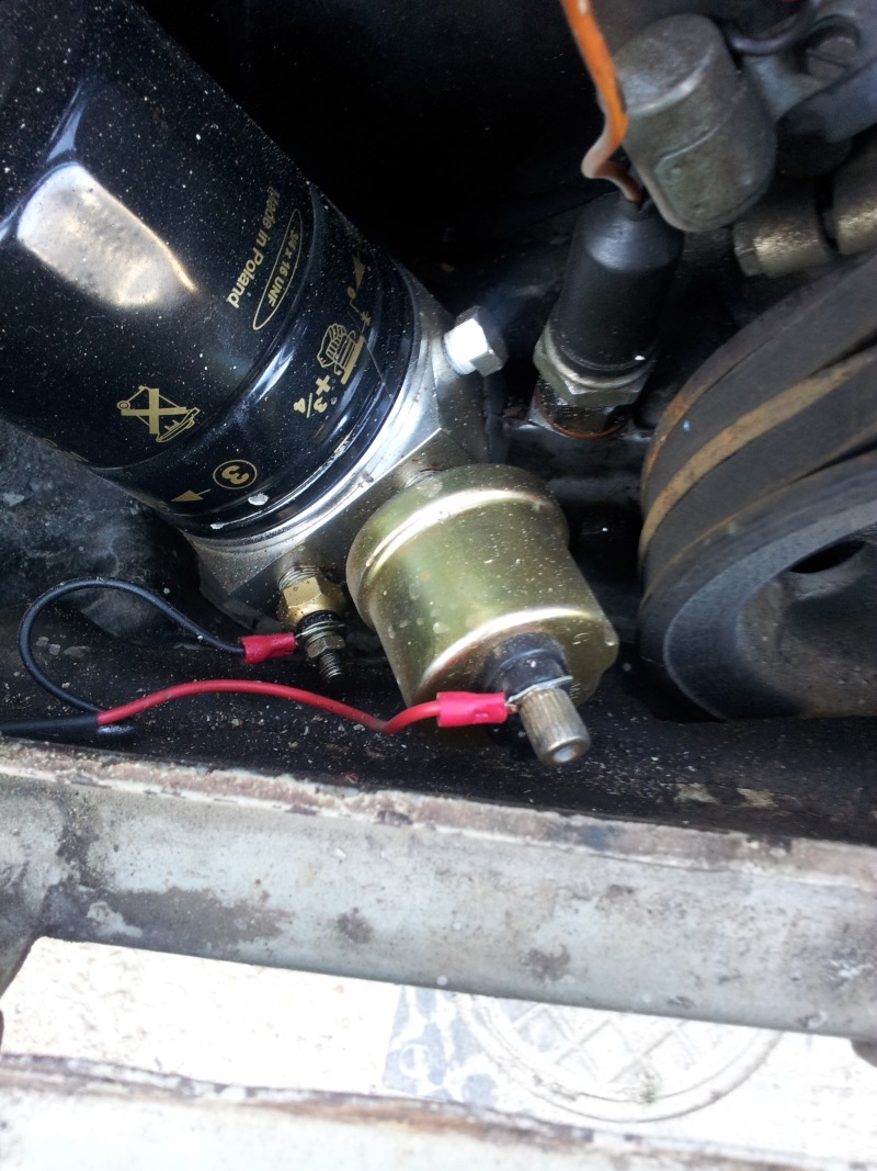

If you don't want to plumb an oil pressure gauge all the way to the front dash, Just putting one in the engine bay would be better than none. At least you could check on the oil pressure.
I would never have known my Haflinger was over pressure without a gauge. The light was obviously off, but that doesn't tell you what is actually happening.
If you have the oil pressure switch up near the oil cooler, then I would suggest a pipe and "T" piece from there rather than than down at the oil bypass valve on the oil filter housing. There is not a lot of usable room near the distributor.

Mark, The spin on filter is a completely housing, but as it is a bolt on item. You could replace your existing paper filter and cover unit with a later housing (if you can find one)!
The later housing allows you to fit a "sandwich" plate like in my picture that has 4 ports which you can attach things to.
In your case with the oil pressure switch up near the oil cooler and not a lot of room around that either, you could do something similar to what Gary Cole has (Can't find a picture. Will post one when found)) This could be fitted to either the oil pressure switch hole or to the by pass valve hole. With a short length of pipe to another "T" piece where you would fit the oil pressure sensor / oil pressure switch / oil temperature sensor. The biggest headache will be deciding what the various fitting need to be - there appear to be several different threads used for these things. Just remember the Haflinger is METRIC and the threads in to the engine will be METRIC rather than anything else.
