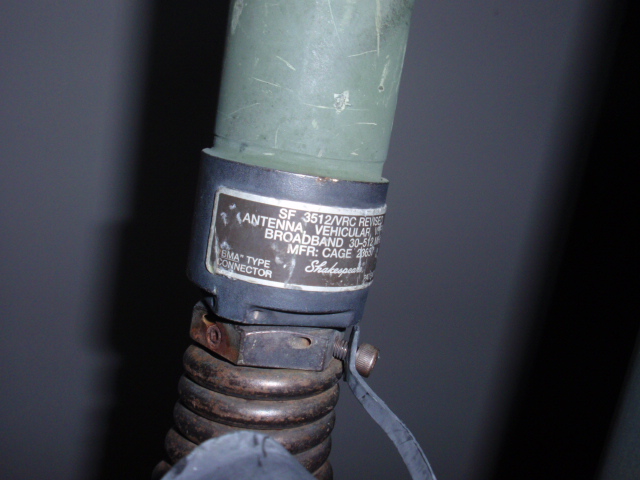

Or you can install the later version Shakespeare SF 3512/VRC 30-512MHz that works without having to turn switches and still looks like it belongs on the Pinzgauer. good for 30-512 MHz with out any adjustments
These can be found on line or at military swap meets for much less than some of the internet sites list them for, however it will take some hunting. These guys list them, a bit rich for my blood however it would save the hunting. https://www.american-milspec.com/p-6600 ... a-new.aspx
Still won't give you much in HF but that's what screwdrivers are for. :lol:

Follow Edzz advice and get the Shakespeare; I haven't found one that suits my budget yet. I use the 15' central antenna for HF with an antenna tuner, although it's supposed to be for HF receive only, or so I've read. It works so-so, but I seldom use the HF on the move anyway. When I'm parked I take out a portable multiband dipole and hang it on a tree. The stock side antennas work OK in 11m (CB) also, but I use mine on 6m, both in parallel like truckers do.
Si vis pacem, para bellum
1976 710K
Re: Pinz Radios
The main problem with the stock antennas is having to manual switch the frequency settings on the base. Being that my truck was missing the masts it was easier for me to justify going to the newer antennas my cost was ~$100 per side IIRC at a military vehicle collectors swap meet that David introduced me to, great bunch of guys a few with good military radio experience and knowledge of what would asn would not work for amateur radio.

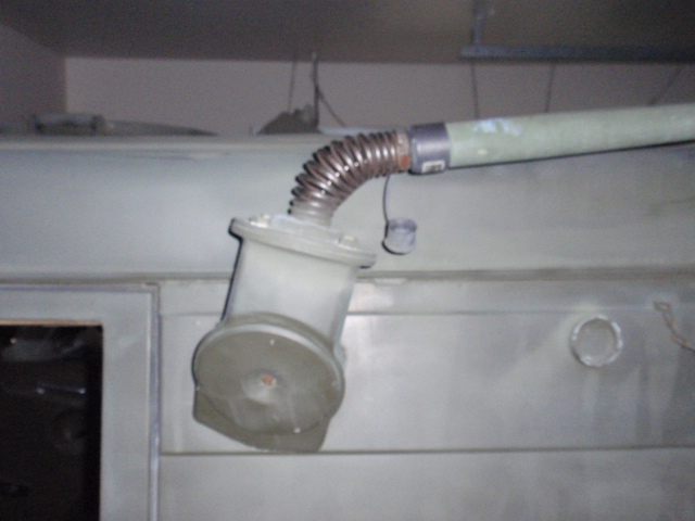

Several mounts available, Witches hat, Light duty spring, Heavy duty lockable spring. These mounts
are 4.5" BHC, identical with the MX-6707 (original spring base for Swiss 710K radio truck), later gen
AS-3900, or Ed's Broadband Shakespeare. BTW, these Antenna are center-feed vertical dipoles, good
when you have a crappy ground plane reference.
I found my parts at "Murphy's Junk" in San Diego, http://www.murphyjunk.net/u-s-issue-com ... ated-items
brand new lockable spring mount, 6 sections for up to 24'. I'll run mobile at 12' tided back, 24' stationary/locked with radials.
