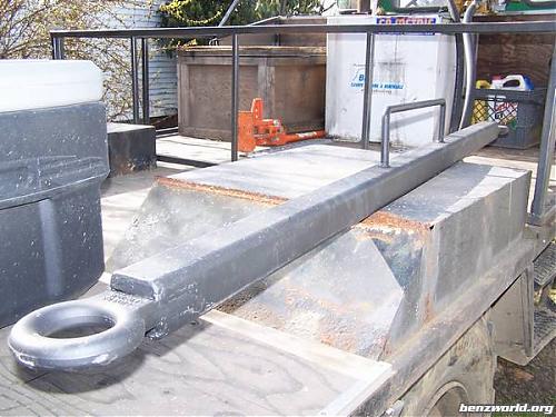

Next suggestion...research for a UniMog tow bar. My recollection is that they were 6 to 8 feet long with a lunette at each end to attach to front and rear of Mogs as there is a similar setup with pins and such. You could have one made of course but there original would give you an excellent pattern to go from.

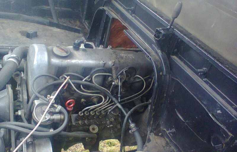

Interesting points thanks for elaborating. I will keep it in mind. Mog bar looks perfect. Thanks for that suggestion. Both trucks are mercedes diesel converted.

Re: Tow pipe?
Mercedes diesel's?
Please tell us more!!!
Re: Tow pipe?
Yes i swapped benz diesel into both of my trucks

Thanks for the pics showing the conversion. Like you, I cannot afford to have my vehicle hauled and not the cash for a trailer or a tow vehicle. I drive to wherever I am off roading, sometimes makes for a long trip. I would imagine the diesels get better milage than my petrol engine for a long ride.

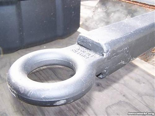

I have a flat tow setup that came with my truck.
I have never used it before, but is not a bad setup.
The guy made a mount that is basically a large bar that sits just off the bumper, but mounts into the pin set up. He then would attach the tow bars (2) to that creating a triangle type mount. Nothing is touching the bumper. Seems legit, but I personally have issues with flat towing, but some people say it's not that big of a deal. Been talked about on this forum at length.

Thank you Texas710 would love to see, i am picturing it good description
