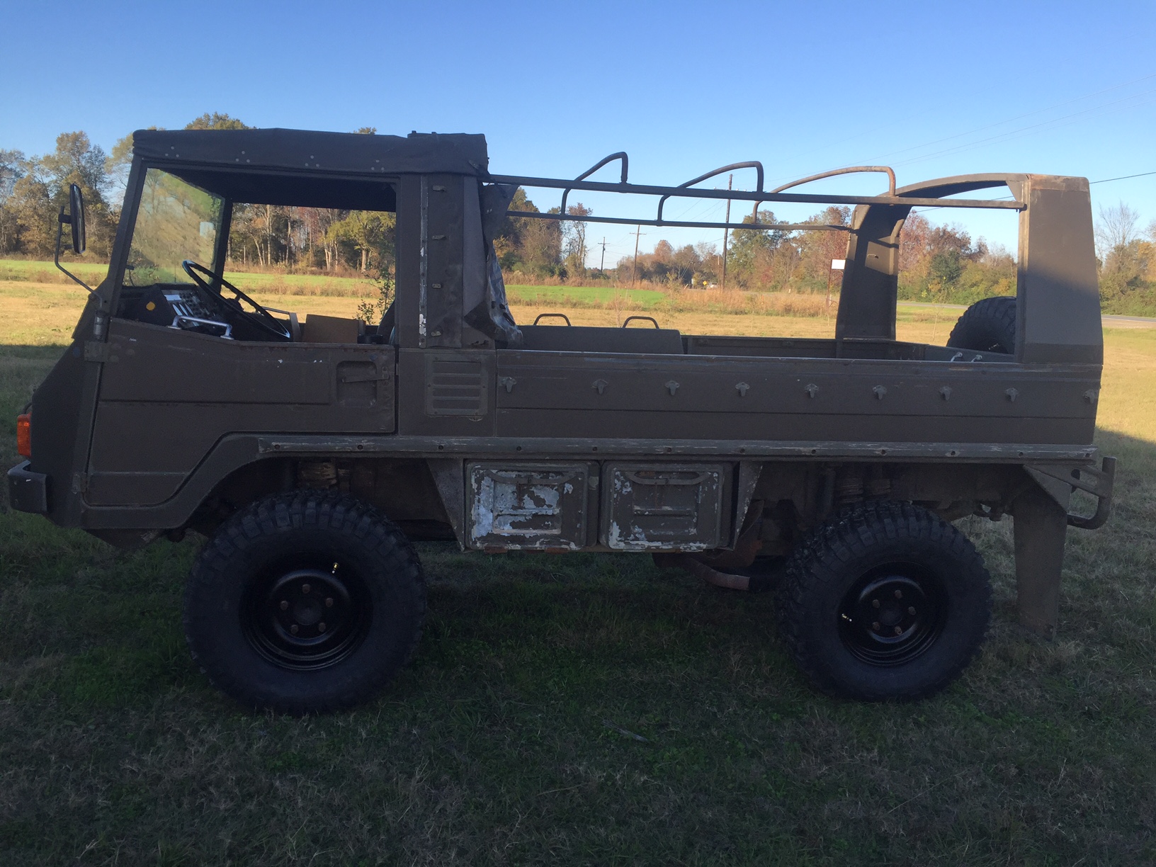

Not yet. I've been covered up on other projects. I did get my wheels all ready. Hopefully I'll get to it soon. Will post pics and results I promise!ImageImage

Great looking aggressive tires. The biggest I could put on were 33" and they did well with no rubbing anywhere.

Tires mounted on rims and rims mounted on Pinz!
Fits great - no rubbing or binding anywhere.
Success! 8)

If possible, could you get the steering full lock in one direction and snap a pic of what kind of clearance you have? I'd greatly appreciate it!
