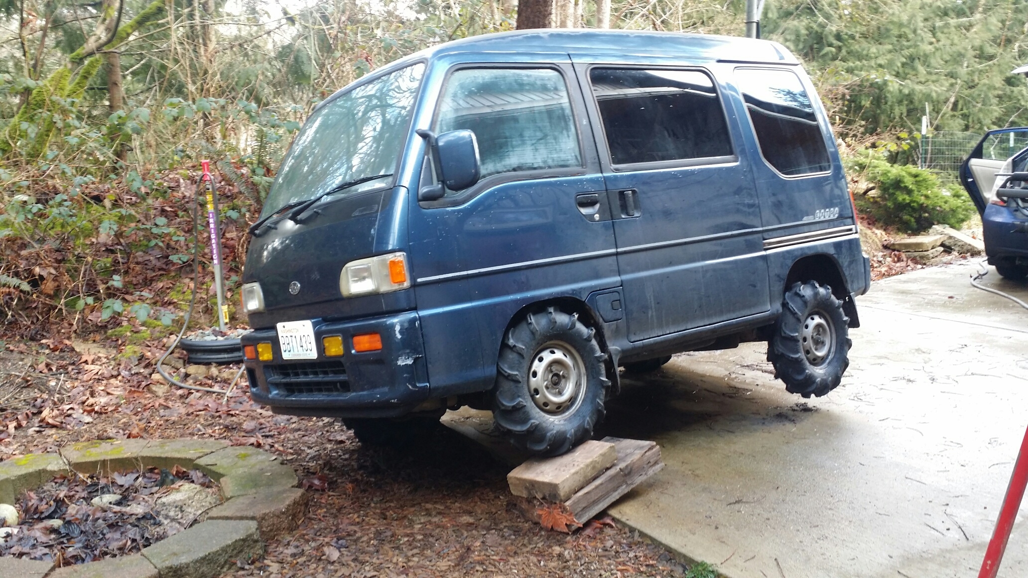

We did just put them on the Subaru Sambar 4WD van and they clear without any rubbing with a 1/4 inch spacer on the front - probably will go with 1 inch hubcentric spacers on all four wheels to make the track slightly wider.
Hard road ride is pretty bumpy ride if pressure is high (24psi) and then the handling is really mushy with them at 12-13 psi - but its great off-road at that pressure. Tires really hooked-in on the test hill - no wheel spin at all.
I do think they are quite heavy duty - I forgot to weigh one but they seem to be thick walled and well made. A great deal in my opinion - especially since they are USA made!
