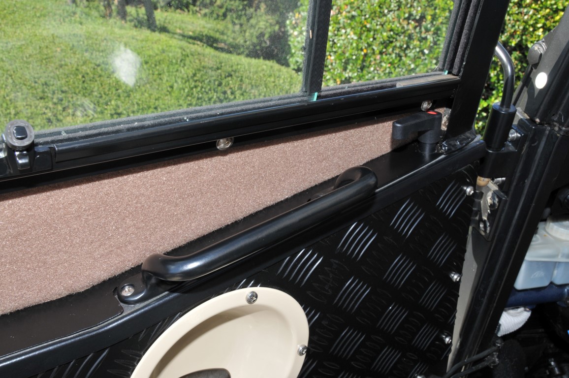

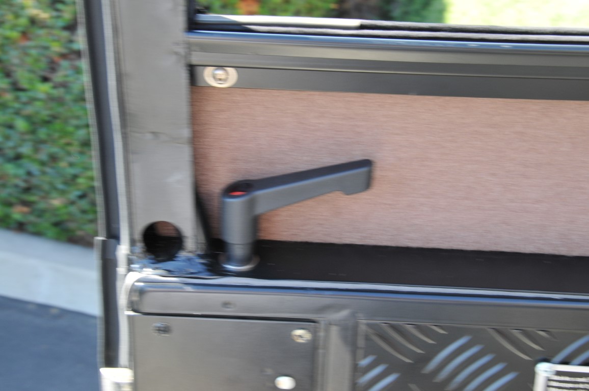

I know notching the bottom of the door out to avoid having to remove the handle is a common trick. I went a step further and
installed some spring loaded quick turn handles. The threaded stem on the front one needs to be trimmed to about 1/4" long to fit.
McMaster part number: 6610K35

Posts: 1549
Re: Toolless Upper Door Removal
Now that's a great hardware find! Thanks!
How about using the M6 thread version instead? It is available with shorter thread length so no cutting required. Would also be the same thread size as the side rails so same tool required.
bikmakr
Posts: 103
Joined: Thu Mar 27, 2014 1:18 pm
Location: Livermore, Ca. Minden, NV
Post by bikmakr »
The doors have M8 weld nuts for the 2 main bolts, so you would need to use M8 studs. Just cut the forward studs to about 1/4" total.
Cut the sheet-metal out around the door handles so they stay with the bottom half when you remove the tops.
I didn't like this method, it takes the strength out of the lower edge of the door tops. I re-attached the pull handles to the door top with "tee" nuts; the handle is removed with the top (With out the top, the door is easy to close). The tee nuts are very thin (<1mm thick) so they don't interfere with the reassembly of the top. I further padded the bottom edge of the door top with "camper tape" to seal the gap when the top is installed, and prevents the tee nut from wearing against the top edge of the lower door half.
