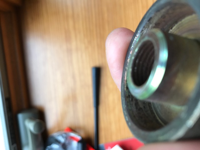

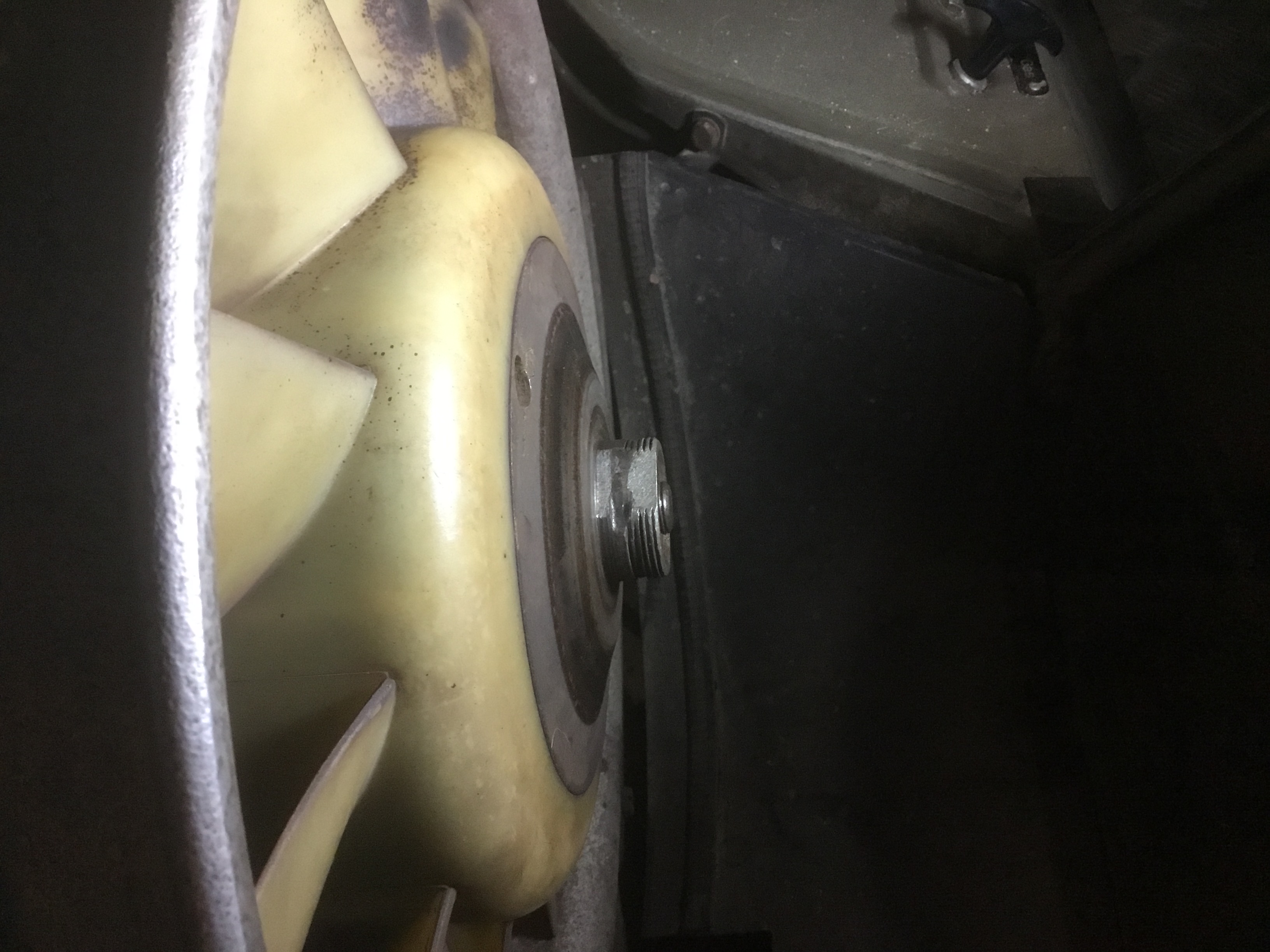

Reviving an old thread because I think I might have a similar problem. Newbie here. The fan nut came off while driving in a similar manner to the op. Was able to retrieve the nut which showed the threads were stripped off leaving little thread shavings on the male threads of the alternator. The threads on the nut were stripped but also corroded, so I just assumed the corrosion caused them to fail, and ordered a new nut from SAV. The threads on the alternator shaft look good.
Since it didn't happen unless there are pictures, here is one of the fan nut with the threads basically stripped off and corroded,
The new nut arrives today, and it doesn't thread on very far. Cleaned off the threads on the alternator thinking that may be the problem, but it still only threads part way in. After reading this thread I am wondering if the new nut is not threaded correctly like the OP experienced.
I can get a 14mm 1.5 tap and run it throught the nut, but I wanted to see if any others have bought a replacement fan nut like the OP only to find the threads were cut wrong.

This may be more due to someone over torquing the fan nut than corrosion.
A not so common mistake but a mistake is to confuse the torque spec for the
Main pulley for the fan nut -- yikes that's a lot of torque! The fan nut is a standard
right hand thread but the fan rotates CW direction -- to loosen, some people get
worried about that and over torque. Depending upon the hardnes the nut may
fail first but damage the shaft. I doubt your new nut is incorrectly threaded. I'd
bet your shaft threads are damaged.

Thanks for the quick reply! I think I can take the fan off and run a die over the shaft threads to clean them up. They look ok, and the nut was the one the shed it's threads, but they could be boogered up a bit. I had to order the tap and die, as 14mm 1.5 isn't a size I could find locally, so one way or another I can sort it out. Was just wondering if anyone else had found the threads on a new nut were cut wrong. It was surprising to me that the OP found that as the cause of his problem.

Got a tap and die, and the threads on the new nut checked out just fine. Cleaned the shaft threads of corrosion and bits of the destroyed nut and it now all bolts up just fine. Glad to have it back running.

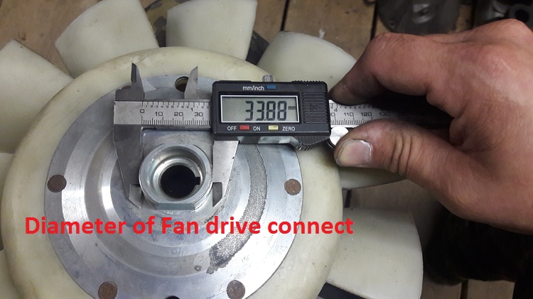

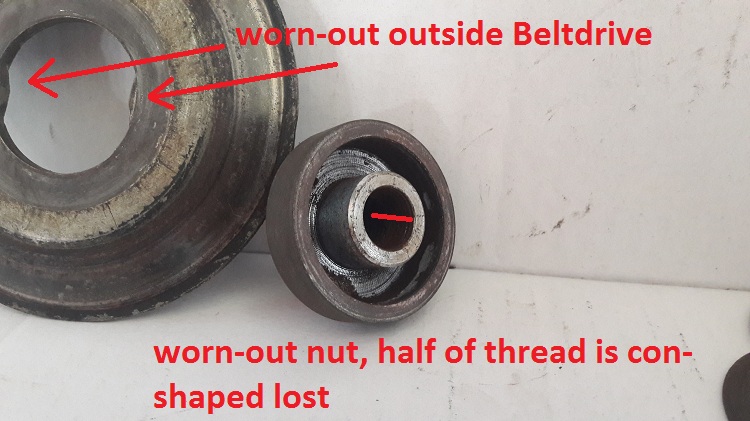

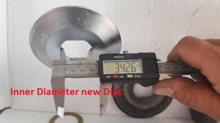

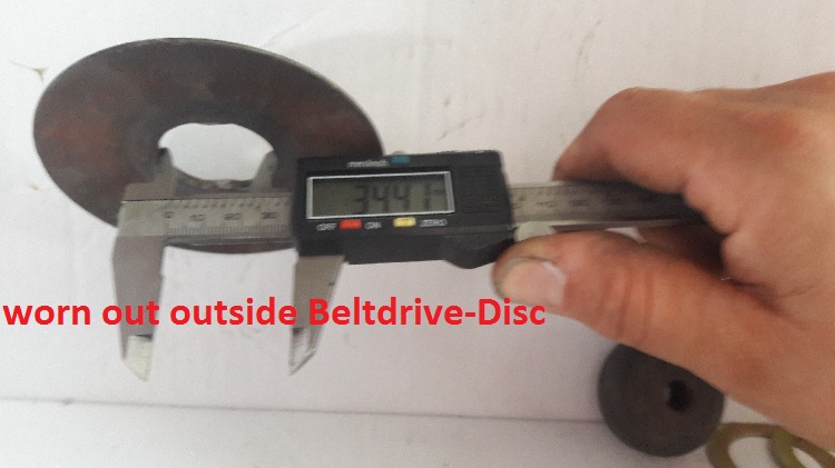

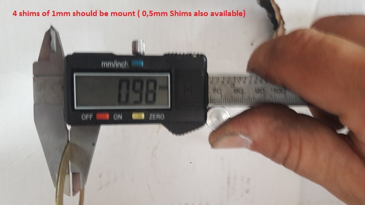

Re: Fan belt won't tighten

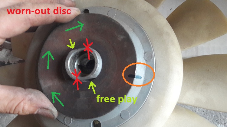

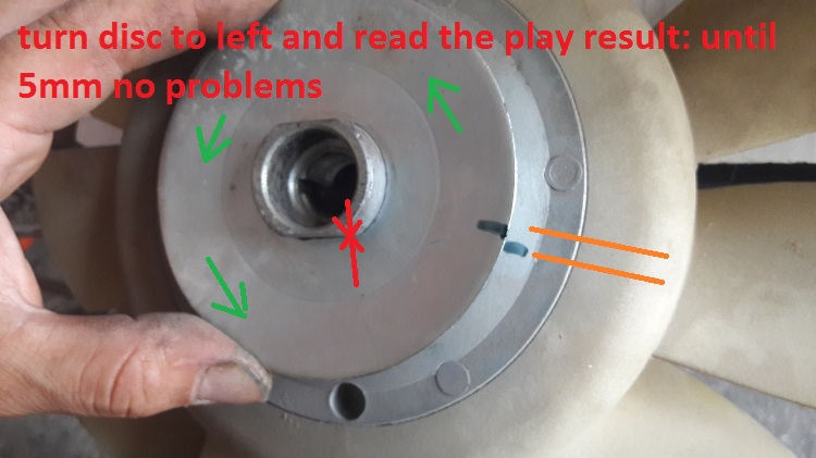

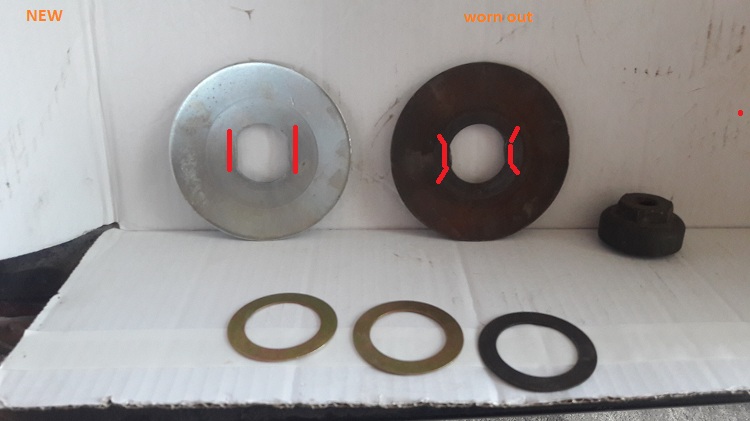

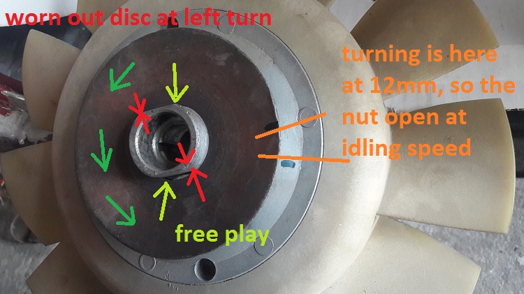

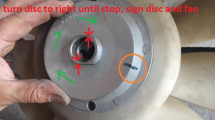

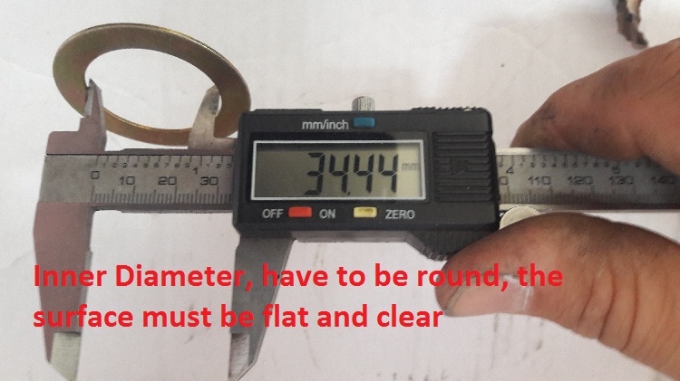

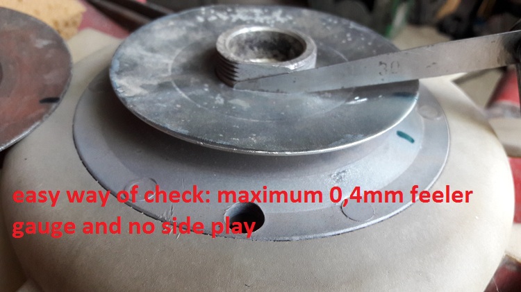

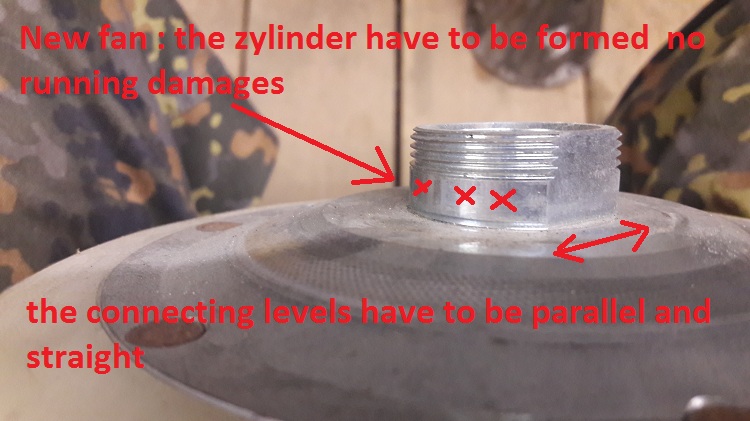

It is a known problem since the haflinger times. if the outside belt drive disc becomes play, the clammping nut is turning open. it starts at each reducting running speed, the crankshaft slows shockly down, the belt slips ( at every thiegthness) and the fan inhibit by the belt. because the fan drive is splitted ito two pieces, the beldt slips over the surface of the cooling fan, but the outside beltdrive disc becomes a torc knock. dust , mud, water and loosened clammping nut makes a faster worn out. it is a slow damaging with making some rattling noise, especially at changing engine speeds and idling running . rattling is coming from setting shims and loosing clamping nut. the clamping nut is worn out in a con shaped form, because of tensile load n the thread and the belt tension. on the thread never comes a looking fluid to fix it. some worn out nuts are holding because from the air entry water runns through the hole of the clammping nut at began to rust. at this cars you can see that the nut hold only on the top of the thread and not in center. four setting shims ( in meaning of 1mm thickness) have to be put in at alltimes, one ever between outside beltdrive disc and nut, because a shim can eliminate the opening twist from Pulley Disc to clammping nut, the surfaces of all pulley parts in the connecting areas have to be flat and clear.
So check fist the connecting part of the fan drive, because here your probies starts.
- 20170629_172224.jpg (109.66 KiB) Viewed 8390 times
- 20170629_172147(0).jpg (124 KiB) Viewed 8390 times
- 20170629_172100.jpg (117.04 KiB) Viewed 8390 times
- 20170629_172115.jpg (84.75 KiB) Viewed 8390 times
- 20170629_172020.jpg (83.27 KiB) Viewed 8390 times
Thank you for this information. The fan nut was worn out more at the opening than deeper inside, so it did display the cone shape you refer to. The half pulley was lost when the nut came off while I was driving so it was replaced with a new one. It is possible that it was worn, but there is no way for me to know now that it is lost. I will go back and check the play with the new half pulley and nut.

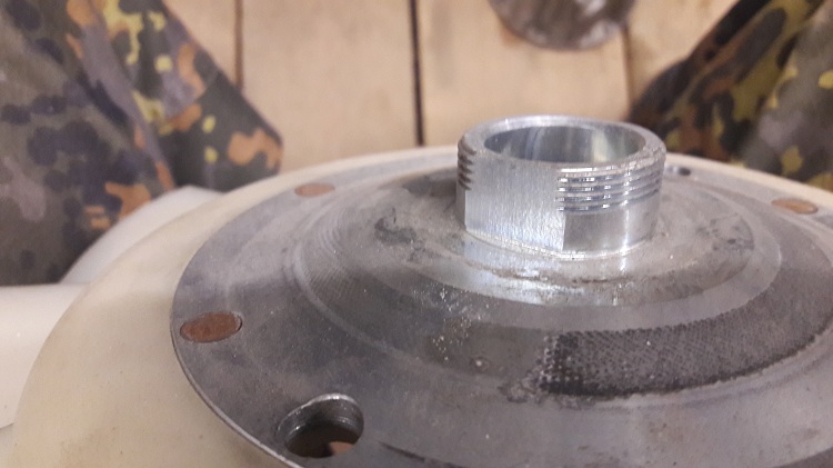

Hello ScottD,
you can overhaul the connecting part of the cooling fan. The Fan have to be removed from Alternator. mostly the fan can be removed by pulling by hand, first spray some rust dissolver on, and pull carfully without twisting the fan on the alternator axle, maybe one person catch with both hands( hand gloves advisable) the fan, another person knocks with a light metall stick and hammer on the alternator center, better on the loosened clammping nut ( without any shims and half pulley disc AND the space from fan to downside nut have to by more than 5mm distance (at 4mm distance the both parts are connected)).if the fan loosen one subsection , spray on rust-dissolver and flush out rust by moving in and out the fan. for reinstall the surfaces have to be metall clean, for resetting take a mixure of oil and anti-seize ( silver type, non ceramic).
the special tool to pull-off is only needed by rusted on parts.
the shown damaged connecter can by short welded ( spot welded) after remove. first remove the zinc plated at damage and welding zone and cover the thread for the pull off section. weld on short points and cool it seconds after by compressed air -flow gun or water bath ( it also can by welded in a water filled trough). after welding it can easy hand machine worked, for rust protection spray on thin layer of anti-rust spray.
the plastic part of the cooling fan can not removed from metall connector without damaging, new rivets and new balancing. Plastic part also didn´t resist a chemical bath for new electrogalvanizing ! so please don´t dismantel the cooling fan wheel !
