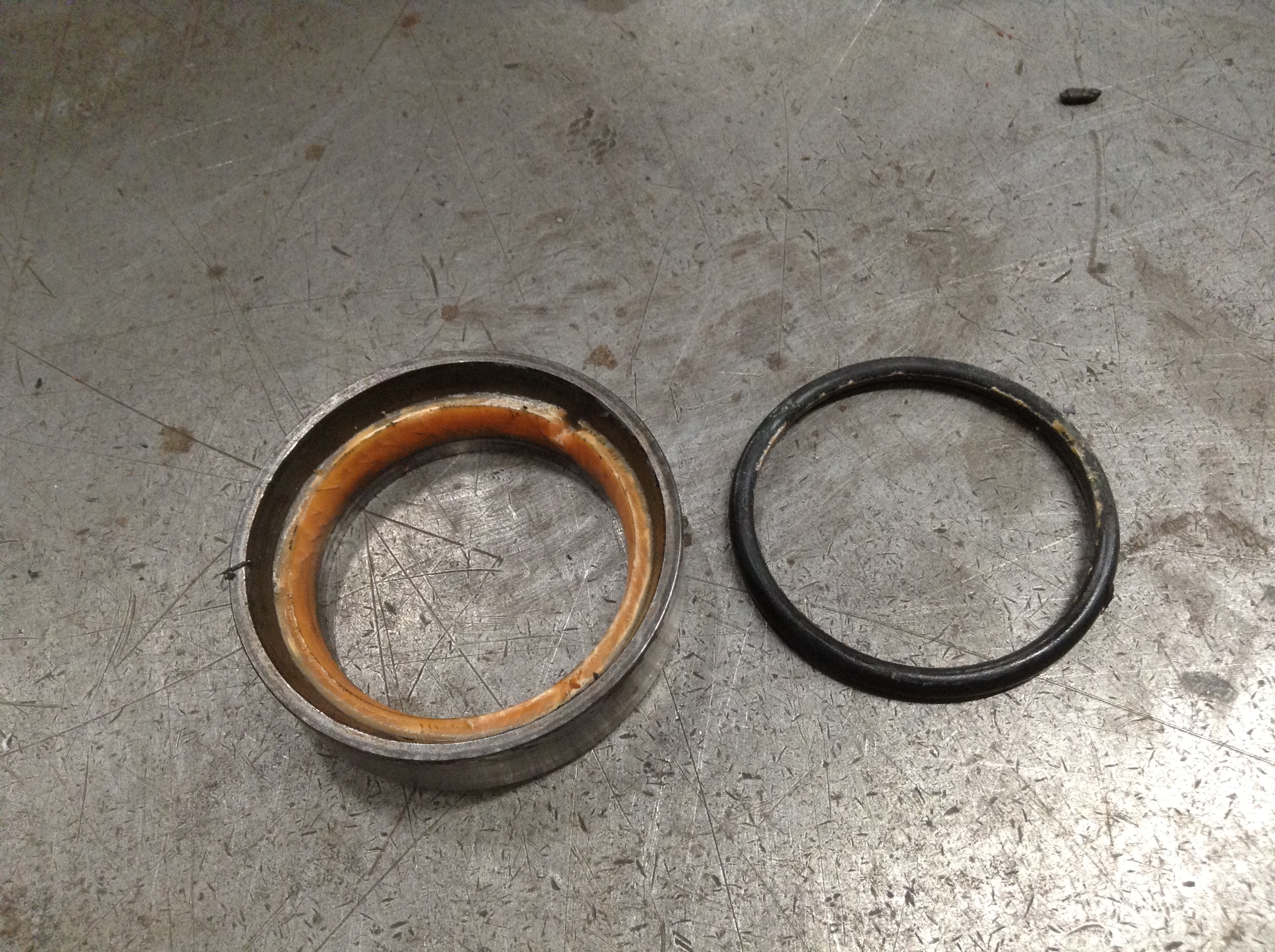

Fixing a leaky hub seal. Noticed the old wear ring has a plastic ring that sits under the o-ring. The plastic ring doesn't show up on the parts diagram and the new wear rings don't have this plastic. Does anyone know the story on these?

There are two spacer rings shown, of different sizes - 55mm and 60mm http://www.pinzgauer.com/parts.php?cat= ... view=04-10 See #16
Perhaps you have some sort of compromise between the two? Maybe somebody made the plastic ring up to account for the difference/s?? Other than that, I dunno.
Re: Wear ring question
has to be something someone "engineered" The 55 or 60 were the size of the wear ring.
I was thinking it was an "improvement" someone made along the way. The two sizes are too different to mix them up in any way.
My guess is it's a setting compound similar to loctite that someone has put there because the o-ring has a tendency to dislodge when fitting new wear rings.
Poor mans repair to make the seal grip better.

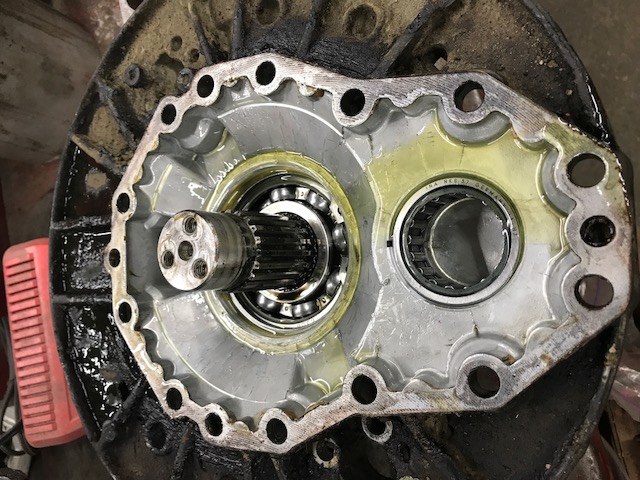

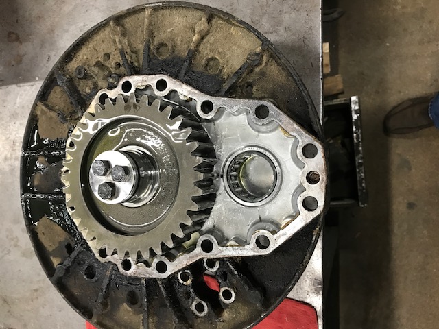

Mine was done at a local auto restoration shop by a mechanic who had done these before, and it went pretty much like the EI video with just a few differences.
1) Instead of using the spindle extraction tool, there is just enough room to support the backing plate from the underside where the special tool bolts would go and push the spindle out with a press.
2) They used a lot of loctite on mine whenever it was serviced last, so it took a bit of heat from an acetylene torch to get things apart. Even the splines on the wheel flange gear were covered in loctite.
The mechanic is very familiar with my truck and was kind enough to let me look over his shoulder the whole time so I could learn from him. Here are a few pictures.
