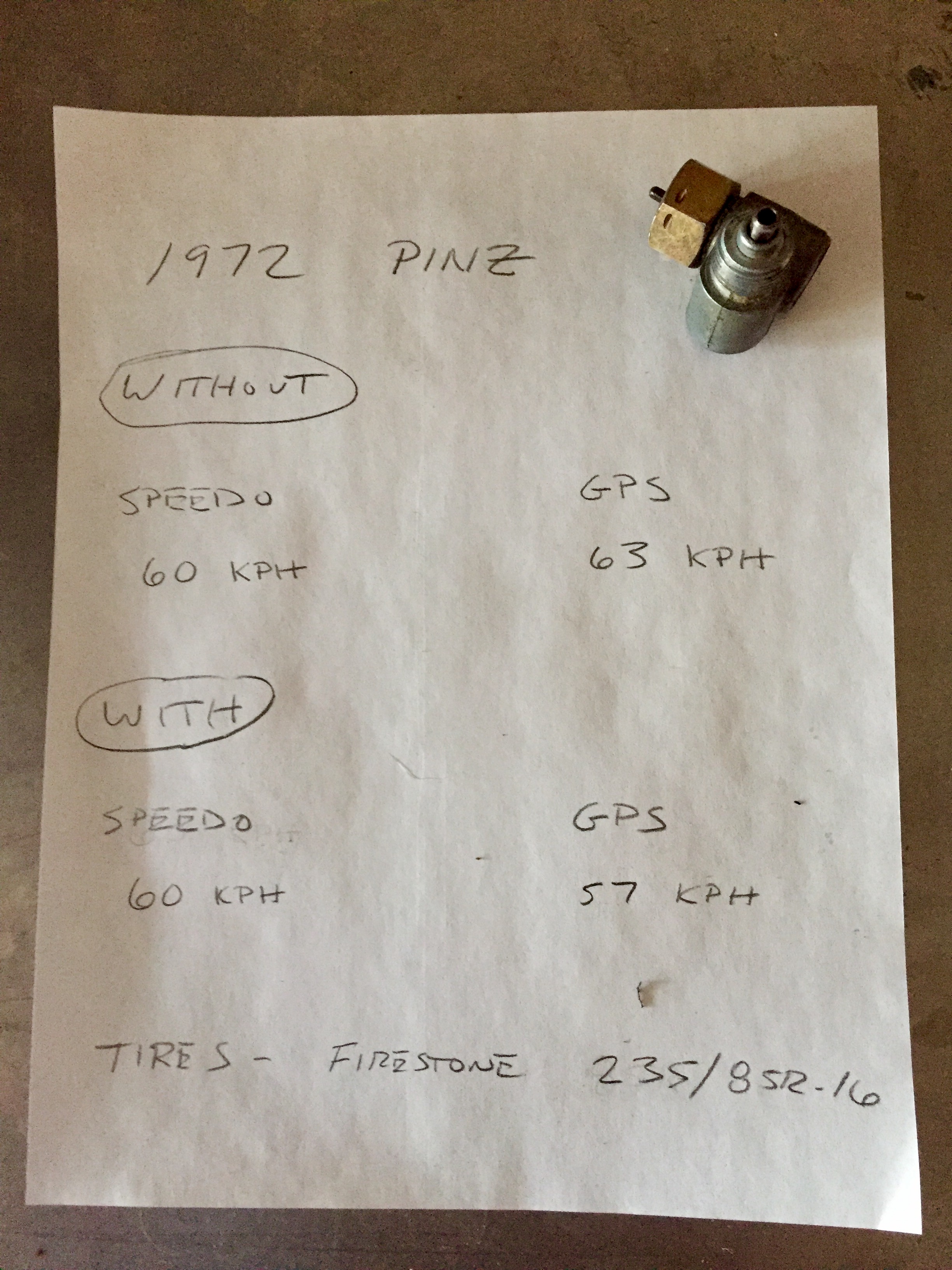

I know this thread is several years old but today I decided to pull and lube my speedometer cable. I was curious on my speedo reading vs GPS with and without the 90° widget.
My test results are shown below.
In the end I decided to remove the adapter from my truck mostly because my speedo operated so much smoother. Needle was rock steady with no bounce. With the widget installed I was getting needle bounce at mid to higher speeds.
