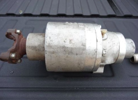

I HAVE AN OLD HONE-O-DRIVE AUTONOMOUS OVERDRIVE UNIT. IT DOES NOT FIT BETEEWN THE GERABOX AND THE T-CASE .
http://hone-o-drive.com/shop/
BUT WHAT IF: I CUT THE “DISTANCE PIECE” IN TWO PARTS (NOW IS 260MM, ONE WOULD BE 200MM AND THE OTHER 160 MM) AND BUILD IT BACK THIS WAY: BACK DIFFERENTIAL – 200 MM DISTANCE PIECE – T CASE – 160 MM DISTANCE PIECE – CENTRAL TUBE.
I WOULD NEED TO CUT THE SHORT DRIVESHAFT BY 160 MM AND ADD 160 MM TO THE LONG DRIVESHAFT.
THIS WOULD GIVE ME AND EXTRA 160 MM (ABOUT 6 ¼ INCHES) TO FIT THE OVERDRIVE.
¿ COULD IT BE DONNE? , ¿OPINIONS?
Thanks in advance
Thanks in advance
- HONE O DRIVE.jpg (41.59 KiB) Viewed 7236 times

Not sure if the T-case could be moved back as described... will look next time I am out at my shop. Would be a fair amount of work I think.
Another crazy idea would be to put the Hone-o-drive unit inside of the spacer between the T-case and the rear differential - its about the right length (around 10 inches) and no flex couplers (u-joints or CVs) would be required there. I don't know how you would service it inside that casting - and - you couldn't use it in 4WD of course!

Wow, I like that Hone-O-Drive idea!Haf-e wrote:Not sure if the T-case could be moved back as described... will look next time I am out at my shop. Would be a fair amount of work I think.
http://hone-o-drive.com/hone-o-drive/
"upgrades and improvements allow the unit to offer performance specifications of 1,000 HP and 1,000 ft-lbs of torque for vehicles up to 8,500 lbs GVW"
Only draw back is high cost of unit

Haf-e wrote: - and - you couldn't use it in 4WD of course!
To me, not having 4WD (or 6WD) in a Pinzgauer would also be a drawback. (Why else would you own one, just for looks?TechMOGogy wrote:Only draw back is high cost of unit

You could still use 4 or 6 wheel drive with the overdrive in the normal 1:1 position...undysworld wrote:Haf-e wrote: - and - you couldn't use it in 4WD of course!To me, not having 4WD (or 6WD) in a Pinzgauer would also be a drawback. (Why else would you own one, just for looks?TechMOGogy wrote:Only draw back is high cost of unit)

It seems like I would have to build a special space part or make the central tube longer ( and the axle )
Haf-e idea ---The space part looks short to fit the overdrive inside , I could make it longer and move the rear tires a little to the back . there are a few Pinz with longer wheelbase
