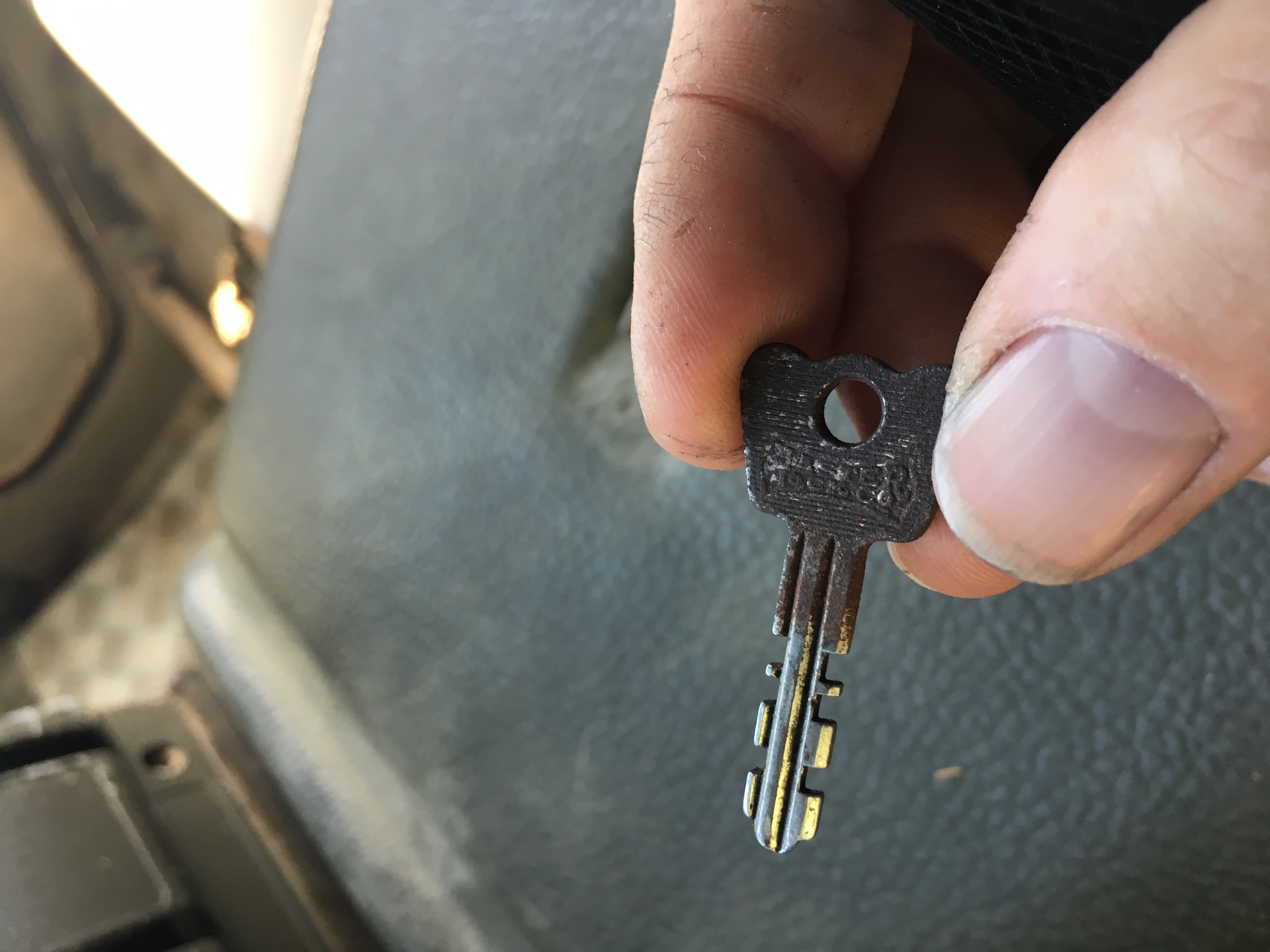

I figured this question would be suited under electrical. I have a '73 Pinzgauer 710M and the key is stuck in the ignition. It starts and runs great etc. But when in the off position the key can't be pulled out.
Any thoughts or ideas would help.

Never heard of this with a Pinz as the key is so simple in design and their is no “iginition lock”
I would say either the key is bent or was damaged or perhaps the key cylinder is not returning to full original position.
G wagons have an ignition lock and the key can get stuck, as the cylinder will not turn, I have read that guys use something that vibrates like an electric toothbrush holding it to the key while trying to wiggle/turn it.

Thanks. I'll have to take a picture today. The key doesn't look like the normal Pinzgauer key, so I'm thinking the previous owner jamb a key in there. There is play in the key, meaning it does wiggle a bit. I'm going to try looking at it closely to see if I can see if it's bent in there, currently the key doesn't bend easily. I hope I can fit it without having to drop $250 for a new one.

I got the key out and sure enough after cleaning it, it’s a master lock key. Inside the key hole there’s a silver bit that dropped down locking it in place. I can stick a screw driver, or any flat metal to use as a key unfortunately.

Rumor in the Swiss Army was (never seen it tested) that if you were stuck in the middle of nowhere with no key but had to start the truck, the bottle opener part of every soldier's knife would do the trick.
So your situation may not be just the result of the previous owner's poor choice.
