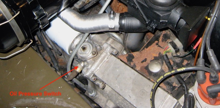

Can someone kindly share where the existing oil pressure switch is located? Can I use it to drive a relay to turn an electric fuel pump off, in the event I lost engine power?
Re: Oil pressure switch ?
Don't know about the relay.
bbonomo
Posts: 30
Joined: Sat Mar 10, 2012 10:39 pm
Post by bbonomo »
Thank you! Dumb question, what does it do? I assume that it's simply a sensor to drive the light on the dash. Correct?
If I'm following the schematic correctly, +24V is run to the oil pressure warning light on the indicator strip and then a wire proceeds from the second terminal on the warning light to the sensor. If the engine loses oil pressure, the pressure switch closes to ground and illuminates the warning light. This is also why the light is on when you turn on the ignition switch.
So, yes, you are correct.
