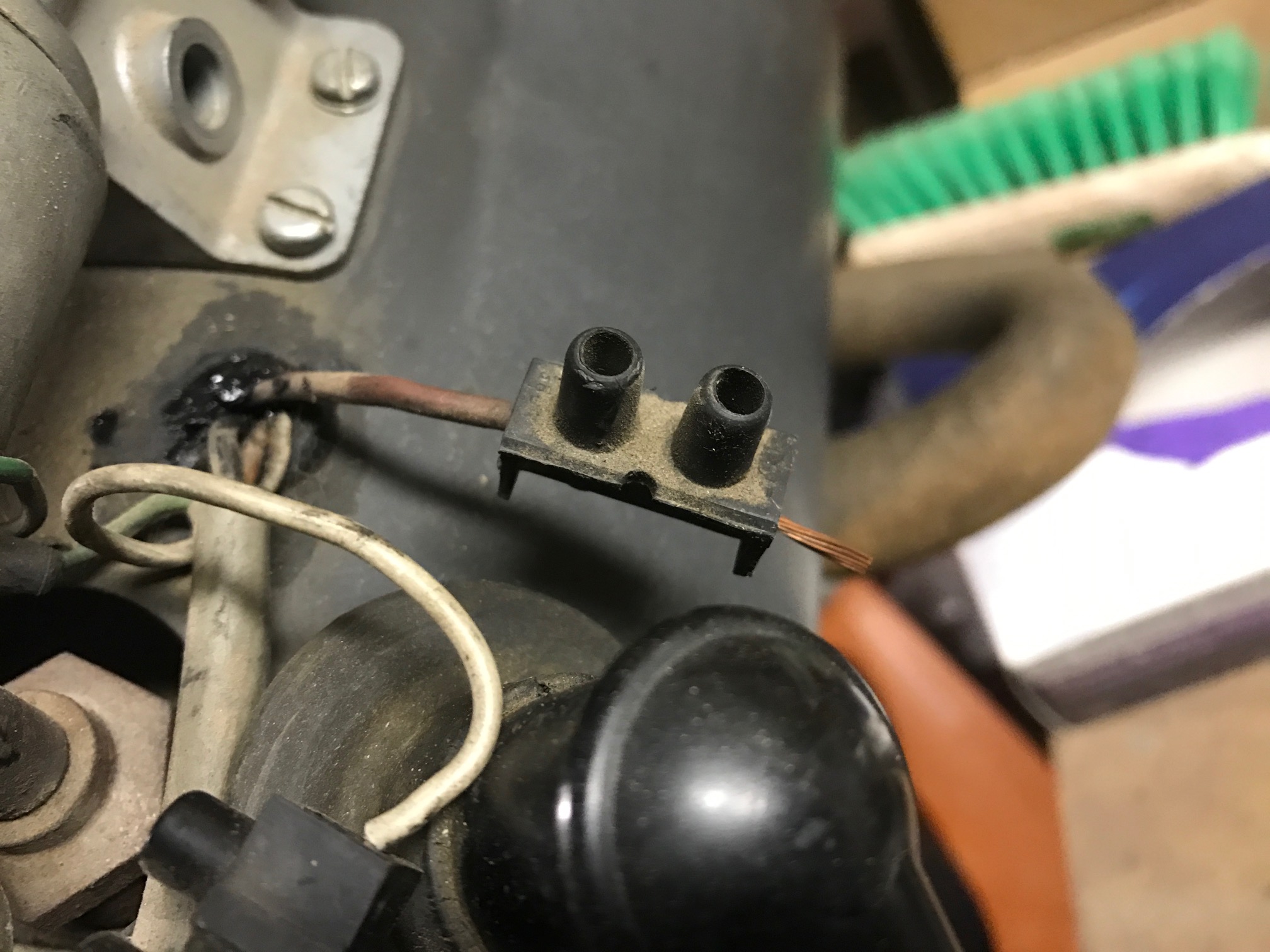

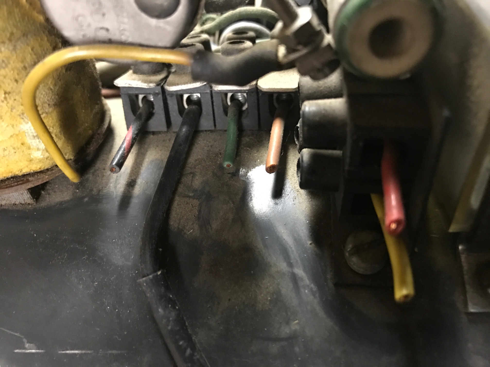

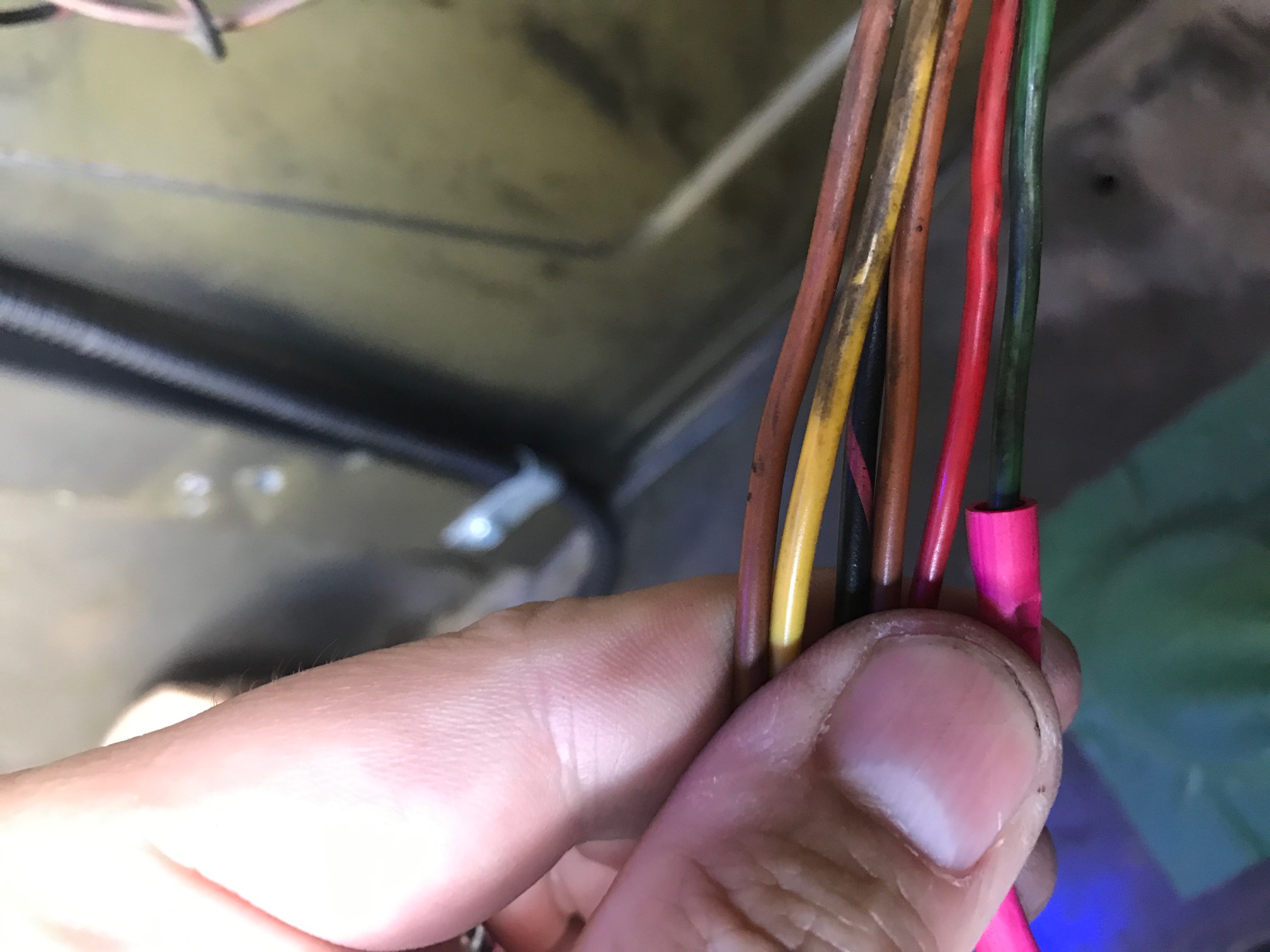

Hello all, maybe someone can help me with my heater re-install?
I have a 710k that came with a BN4, but it wasn't installed. It definitely came from this Pinz as the wires are cut off in the same fashion.
Luckily they left some ends, so I can match the colors when i put it back in. However there are a couple that are uncertain- there are 2 brown wires on the heater, and there are 2 brown wires in the Pinz- but I'm unsure which ones go where. On the heater one of the brown wires is with the other on the top harness, the other one comes out by the air inlet.
Also, in the main harness of fetch top there is one thicker black wire with a fuse that doesn't seem to correspond to anything in the Pinz. usually thicker black wires are ground, but I don't want to make any assumptions on this one- plus ground wires don't typically have inline fuses.
Any help would be fantastic!
