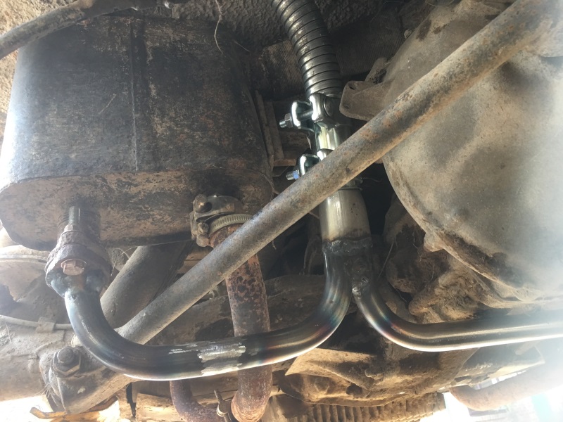

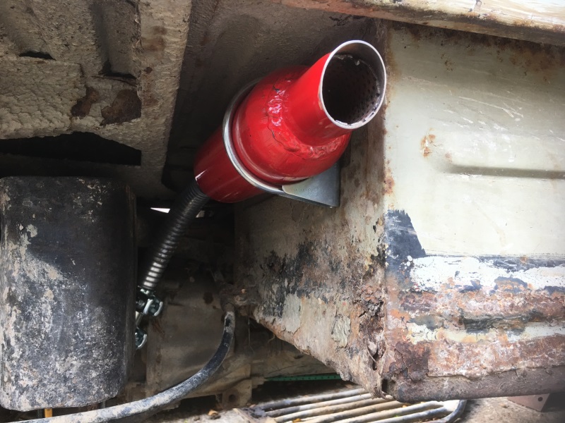

I built a "cherry bomb" silencer for Lurch - it's a bit loud as it is basically a straight through pipe, but if you are looking for something quite your biggest issue will be to find a silencer which has less than a 2 inch diameter pipes in and out. Haflingers have 1.25" pipes from the manifolds and the exit pipe on the standard silencer box is less than that.
New exhaust system 1.jpg (169 KiB) Viewed 8608 times
New exhaust system 2.jpg (166.08 KiB) Viewed 8608 times
New exhaust system 3.jpg (179.15 KiB) Viewed 8608 times
Lurch has the Heat exchanger heating system.
