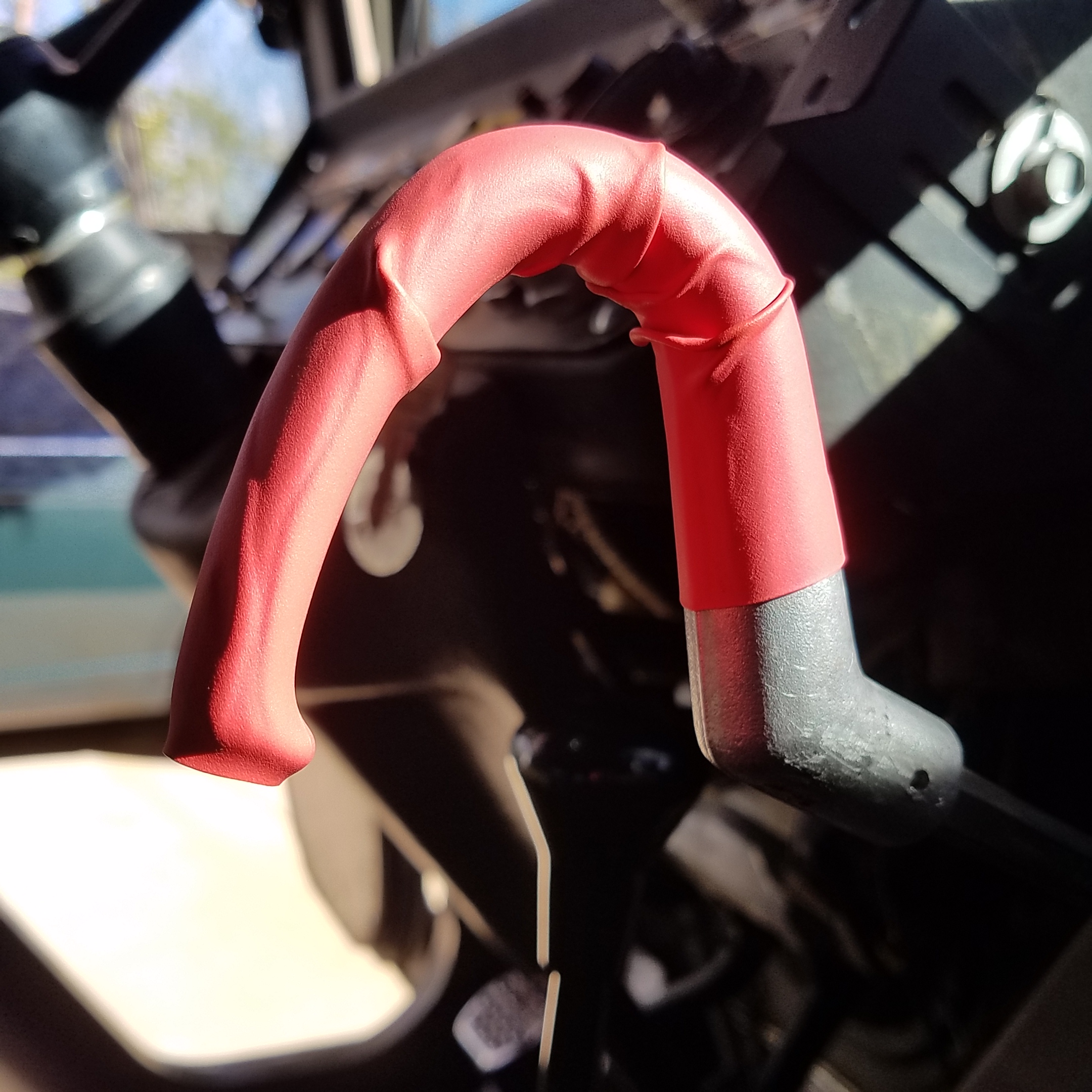

mm58
Posts: 241
Location: Tucson, AZ
Re: E-Brake handle plastic coating
Post by mm58 »
3/4" 2:1 shrink tube. The bends were just too tight to get the tubing to lay out nice and smooth.
You can see how it bunched up with wrinkles and overlaps.
Oh well...back to square one :DD

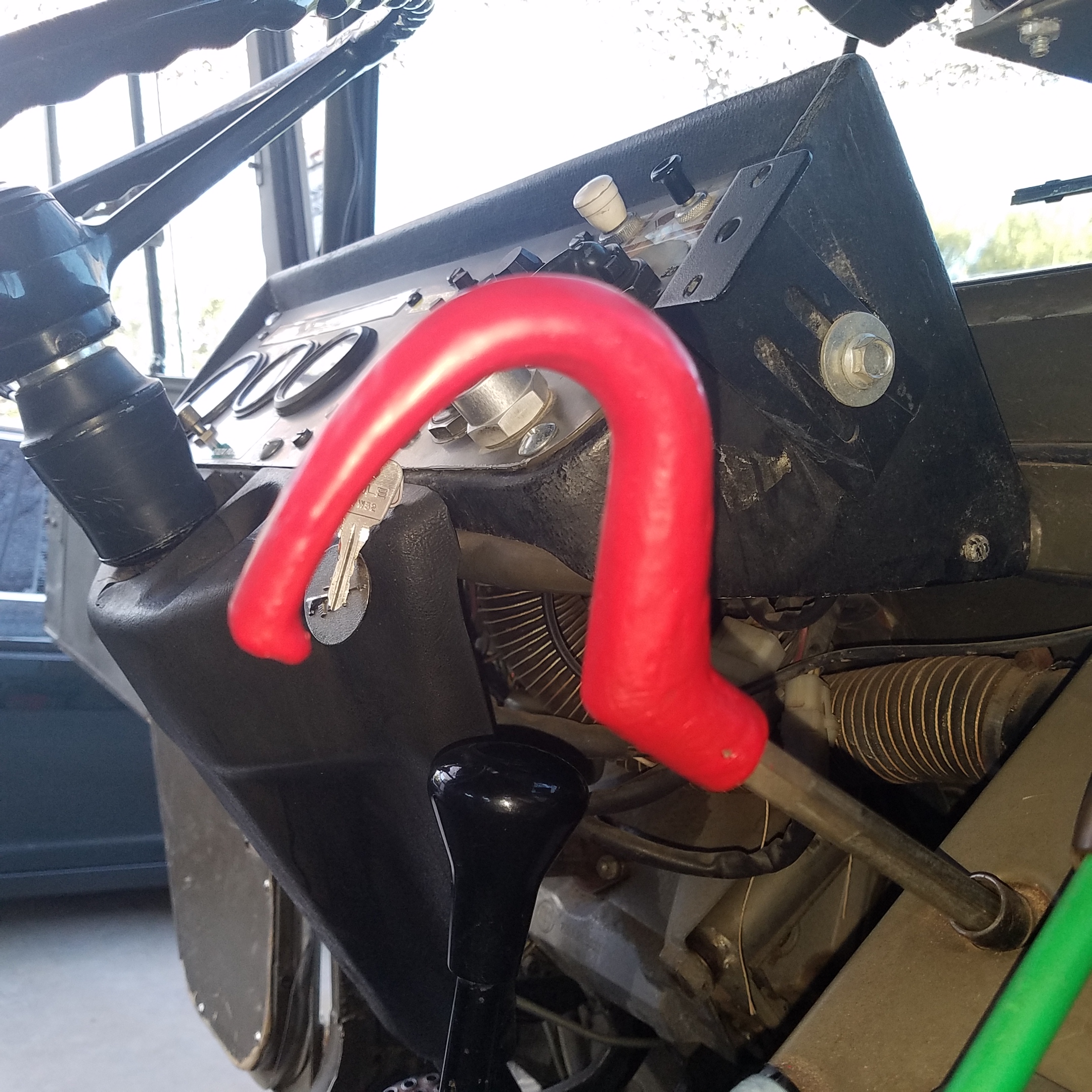

As much as I didn't think Plasti-Dip would work well, forum member "bumber"
encouraged me to give it a try.
Because the retaining pin is frozen (I can't even drill or drift it out),
I had to apply it in-situ with a small acid brush.
Pic is after two applications letting it dry completely in between.
I'm really surprised how evenly it flowed out, and it seems to be pretty tough.
It has a nice soft rubbery feel, but not so that it feels like it's going to easily peel off.
Wow, that came out really nice -- and done in place to boot!
Gotta bookmark this page :wink:
Nice!
