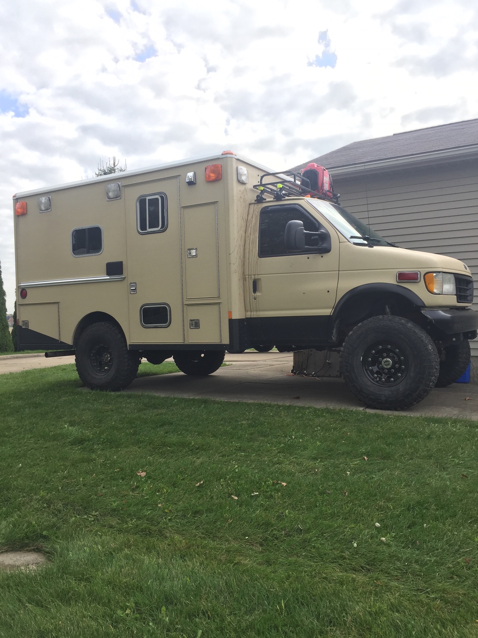

Has anyone looked into Fox 2.0 smoothies? I had them on my van (attached) and fr as long as I had it they were golden. If you use the right seller you can provide them with the specifics f your ride like total weight, weight on each axle, and intended usage, and they will tune them for that before they ship them to you. Cost is sub $200/each.
