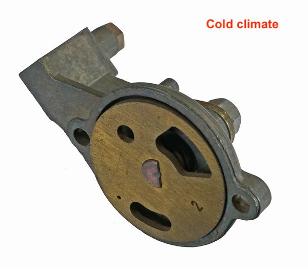

These carbs use a choke mechanism that actually increases the amount of fuel rather than decreasing the amount of air to enrich the mixture, as in most carbs. So if the choke is not adjusted correctly it is actually dumping extra fuel down the carbs. The problem of engine oil diluted with gas has been reported a few times over the years and has sometimes been traced back to the choke and sometimes to leaking body gaskets in the fuel pump. If you are in a warm climate and have the cold-climate choke plates installed, the problem of an improperly adjusted choke is likely to be more severe since the cold-climate plates provide greater fuel flow.
edit: I forgot that the proper name for the choke housing is "starter body". Here are a couple of photos borrowed from Swiss Army Vehicles to show the difference between the 2 starter (choke) plates.
