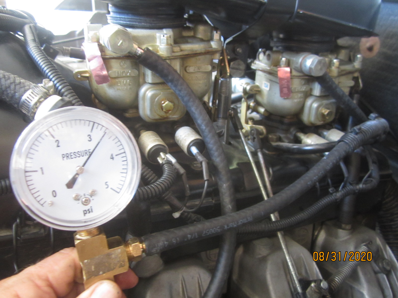

Posts: 940
Location: Indio, California
Re: Engine bogging
Post by pinzinator »
I did some verification tests on the fuel system today and discovered that the recommended pump puts out about 4.3 PSI unregulated. I dialed it back to 3.3 PSI, which took all of 2 minutes using a 16mm box end wrench and a 5.5 Allen. Here are photos-
