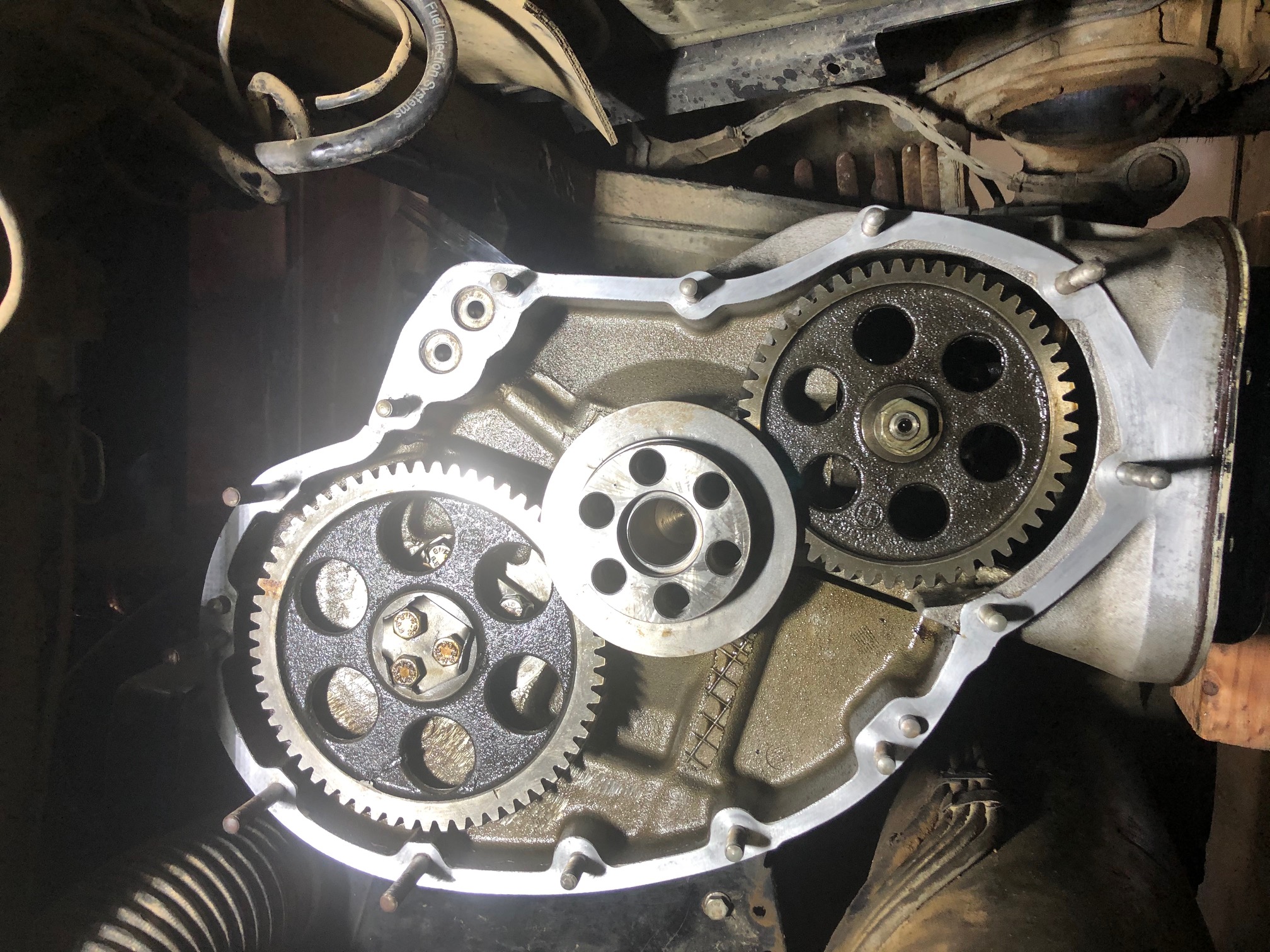

Housing REMOVED and surfaces cleaned:
6. Knock out the rear main seal DO NOT throw the old seal away just yet.
7. A new seal should be pressed in just below the surface, e.g. should be flush at the back side.
If you do not have a Seal setting tool, I used the old seal as a interposer to drive the new seal
to the proper position.

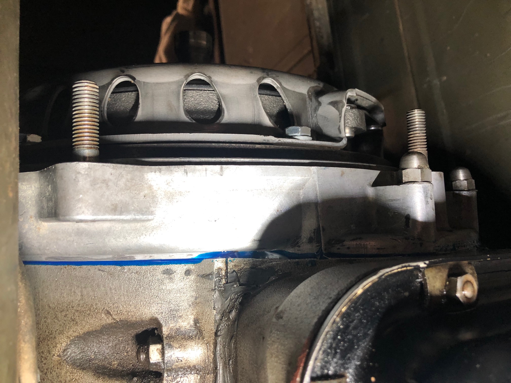

8.2 Apply a fine bead of Hylomar to Engine side ONLY. The engine is sectioned so there is the opportunity for
slight height difference between casting surfaces. Use your finger to spread the sealant thin around the
mounting bolts and seam.

Hylomar Blue Bead flowing out of seam:
