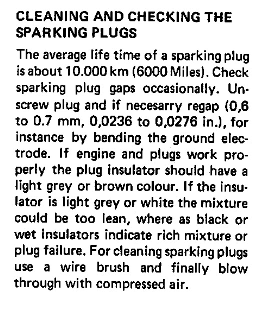

The manual advises to replace spark plugs every 10km/200hr. Has anyone found that necessary? For similar plugs in aircraft, we change them when they're out of tolerance, but not based on hours.

From the Owners Manual, Page 150. This is of course referring to the original military spark plugs. If you have converted to the civilian ignition with conventional spark plugs, your mileage will vary.
Spark Plugs.jpg (155.56 KiB) Viewed 4658 times

Yes, that is the manual I was referring to -- I guess I should have quoted the chapter and verse.
The question was: what are people's actual experiences with practical replacement intervals?
