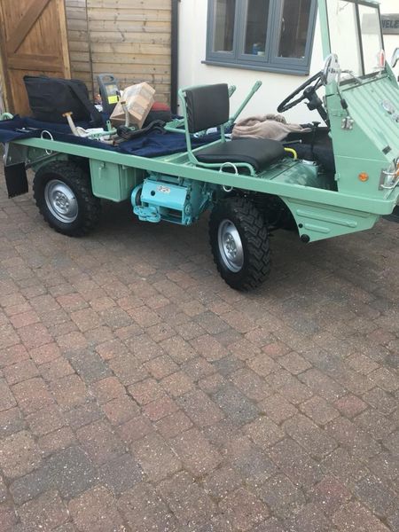

Wel....they had from factory a winchmount up front as a option and i think they had a line of ramsey winches ( 2 or 3 models) .
The one in the picture was a option to and was used ias farming and the uk marine used them as well :mrgreen:
You could go with TR pistons ( https://www.ebay.com/itm/Steyr-Puch-Haf ... 3694374508 ) to get a higher compression to make it a bit more powerfull, but this depends on what type of engine you have...serie one serie two..they all look the same from the outside but are a bit different inside....like different camshafts :mrgreen:
This came with mine : Image

Well i have checked my catalog and theres no mention of a winch mount to put up front, but there is also no mention of the winch that sits under the left side of the haflinger...i know they had to give up one seat to mount it .
Only thing i can find is the PTO assambly for the gearbox and levers.
The winch on the side dous appear in a cattalog where you find the snowplug and welder ??? :mrgreen:
