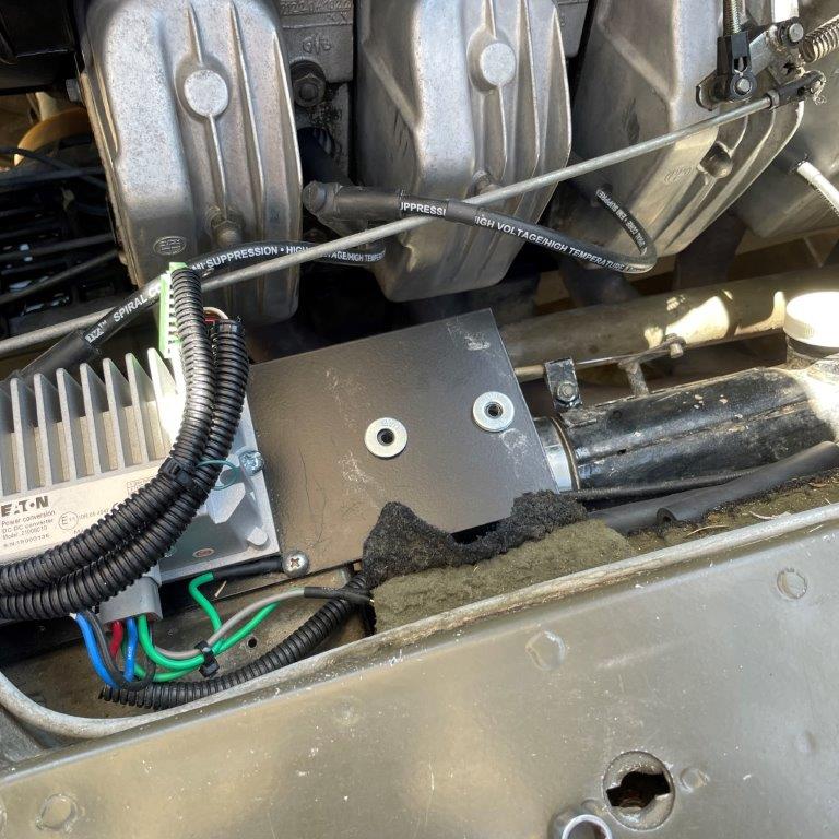

There have been some concerns about water resistance with the 4.0 version, which has been reviewed by our engineering department. There is a simple recommendation to prevent this that can be done in an hour for under $20. All future PinzSSI 4.01 ignitions will include these 2 modifications.
First, remove the coil assembly and stack 2 washers where the mounting holes are to create a gap under the coil plate. This will prevent water pudding under the coils and possibly damaging soldered connections there.

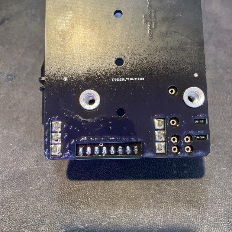

While you have the coil out, use some conformal coating made by MG Chemicals and cover all of the solder connections on the coil circuit board, top and bottom. Just the circuitry, not the coils or voltage converter. This product is available on Amazon for about $13 for the liquid version. Use a small foam rubber brush to wipe it on. 2 coats is good, and it dries fast.

Stacked washers

Underside of the coil pack treated

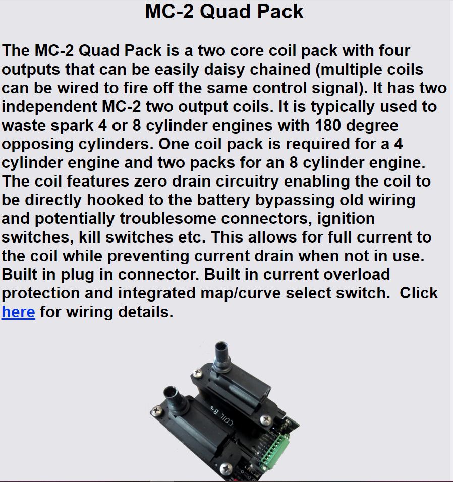

PinzSSI 4.0 ignition coils are available from Powerarc.com for $170. If your Pinz is backfiring or losing power, this part can fail. The coil pack can be replaced in a few minutes, and also be sure that the 4 wires that go into the small green connector are in the correct order, so take a picture first.
Also install a DC filter at the power supply connection, as the Pinzgauer does not produce a smooth voltage. A good filter can prevent future problems and OS corruption. Amazon has these, do a search for DC filter 24 volt 20 amps.
