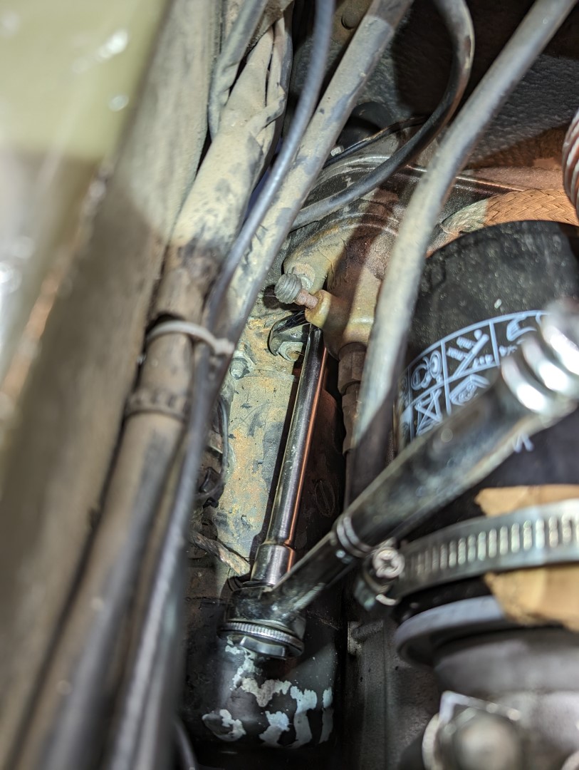

Starter is out and on the bench. Tips for anyone else removing a starter:
- Disconnect battery (just to be safe)
- Remove engine oil dipstick assembly (two bolts), and insert loose a 3/8in bolt into the hole as a cover to keep debris out.
- Get the top nut off with a 19mm crow's foot wrench. It'll be slow, but it'll get the job done. I have a low-profile socket with u-joint on order I'll try for re-installation. https://a.co/d/61XBQTC
- Then remove lower nut and drop the starter out the bottom by tipping its rear up after sliding free of the two mounting studs.

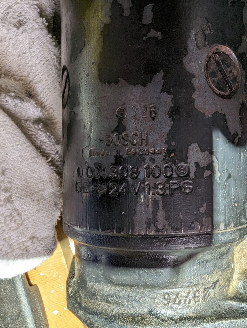

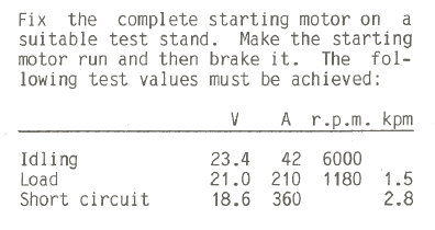

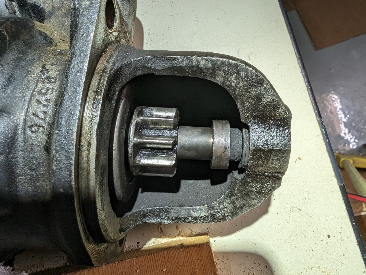

Bench testing was done using the pinz battery stack. 80A inrush current, and 30A running current -- does anyone know if that's typical? Mine is Rev1 (the longer one) starter.
Solenoid seems to drive reliable, with no failures noted after a dozen or so cycles. Even on a 10A-current-limited power supply, the solenoid engages (but starter doesn't spin due to insufficient current and a drop to about 2.5V at 10A). Seems to engage fine on the dual-battery stack of the truck.

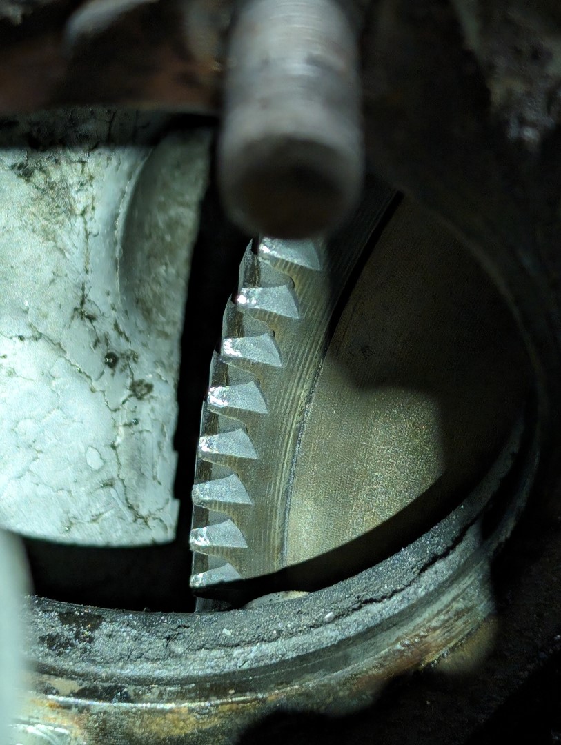

No obvious signs of issues on the drive teeth, ring gear teeth, or the rubber mount. Pictures attached for more expert eyes.
Is the current typical? The manual calls out 42A, so mine is a bit lower, but no range is specified. Ideas for next steps?

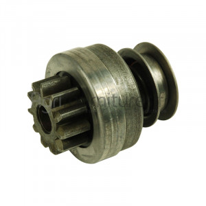

Google translate:
If the starter motor starts but does not drive the engine
we can conclude that the relay is working properly
it's probably the starter pawls that are faulty photo below
it's the same system as ratchet tools or bicycle rear sprockets

After listening to the group and reading the archives, it seems the likely culprit is the Bendix drive (one-way clutch).
The new Bendix (for my v1 starter) seems to be not available (from SAV), and is about $200. Given that, I'm down the path of a new starter when balancing time, effort, and reliability.

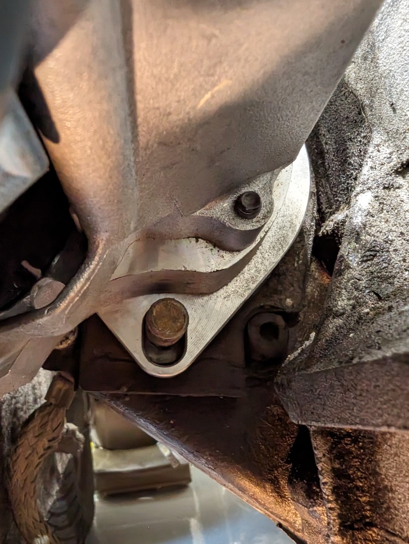

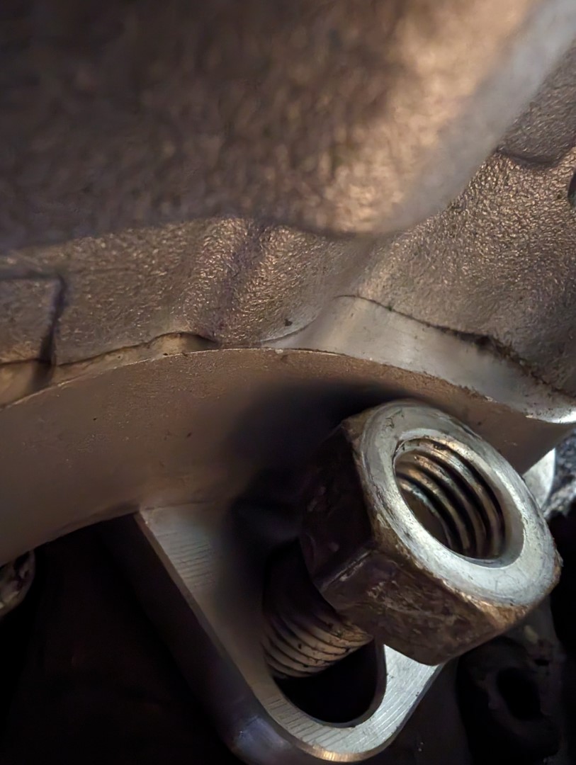

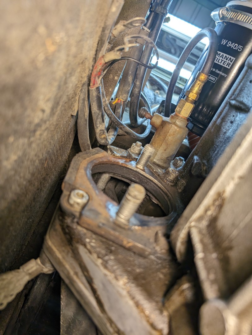

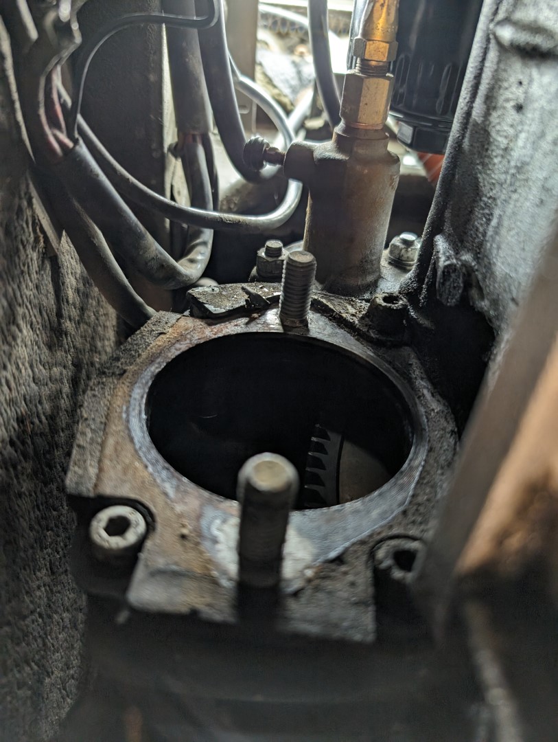

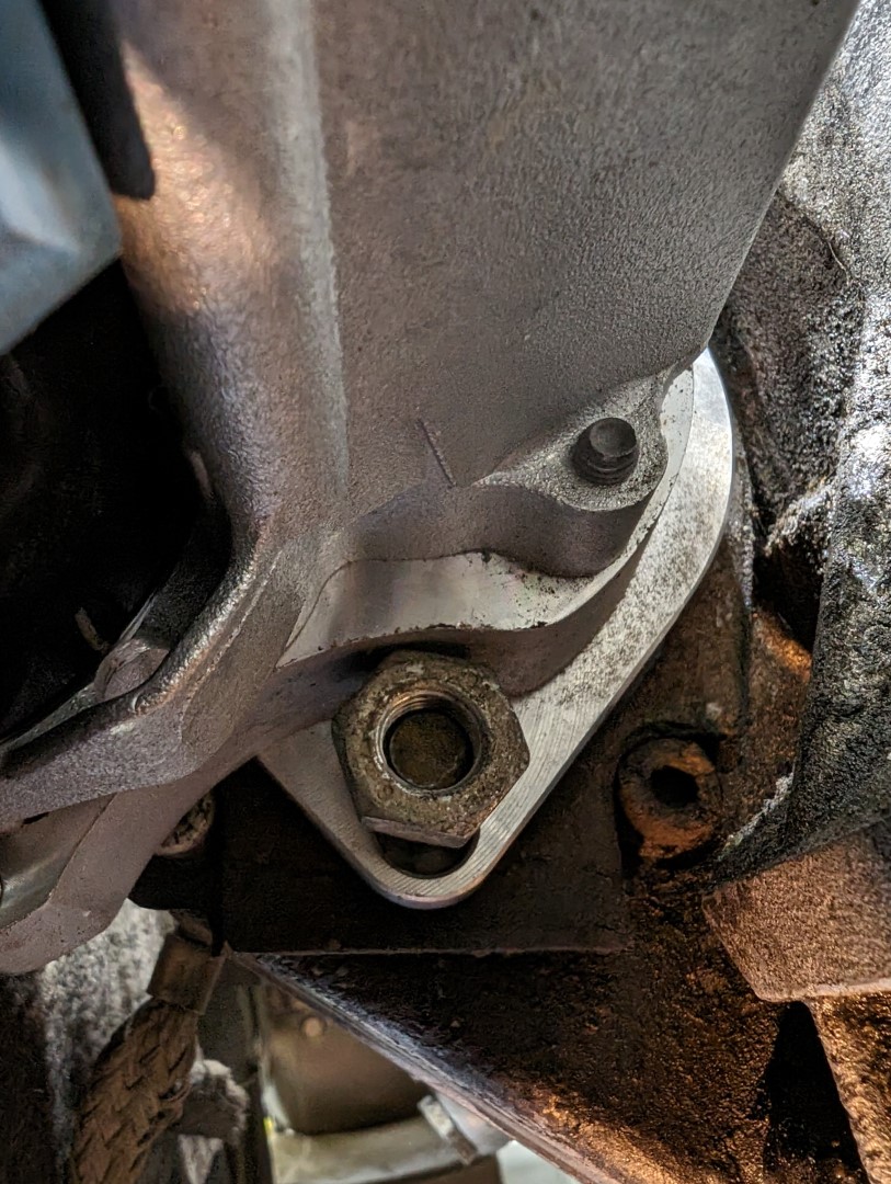

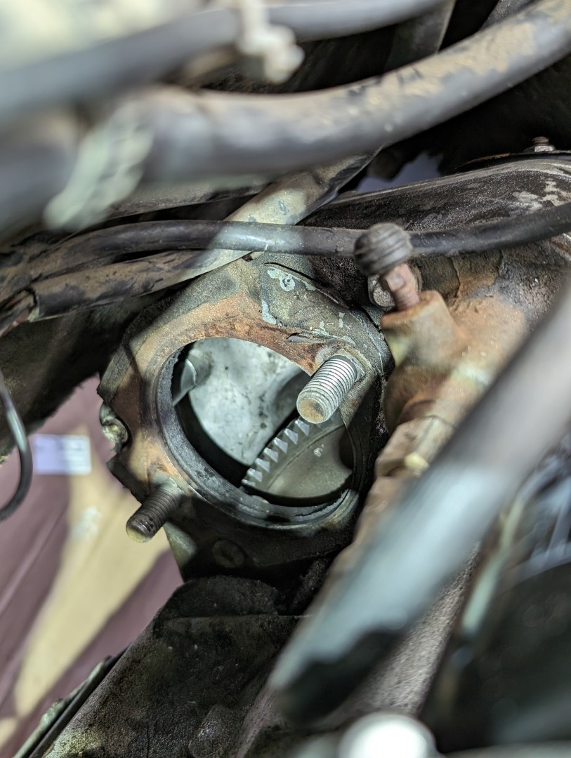

Alas, no joy with the new EI gear-reduction starter. The lower nut & washer won't fit on when the starter is in place and tight against the mount.
I've opened a ticket with EI (Scott), and am awaiting a reply.
Ideas?
Ideas?
