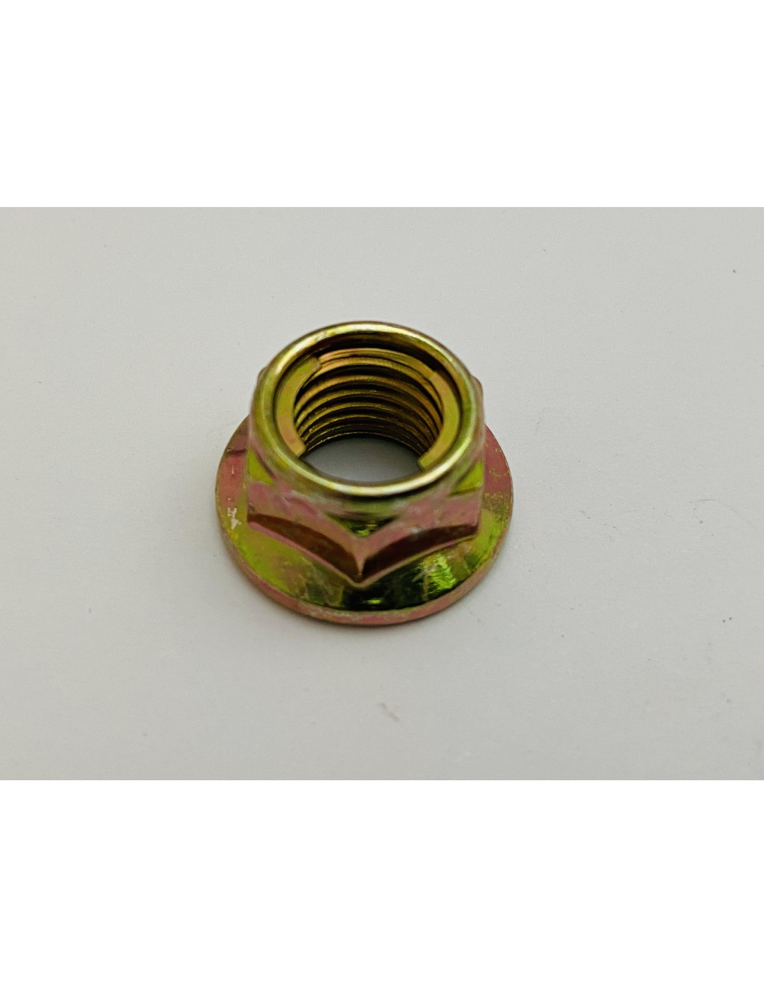

hi
ecrous de 10mm head 14mm
https://www.rawmotorsports.net/fr/piece ... 14-29.html
https://www.sip-scootershop.com/fr/prod ... e_87261500

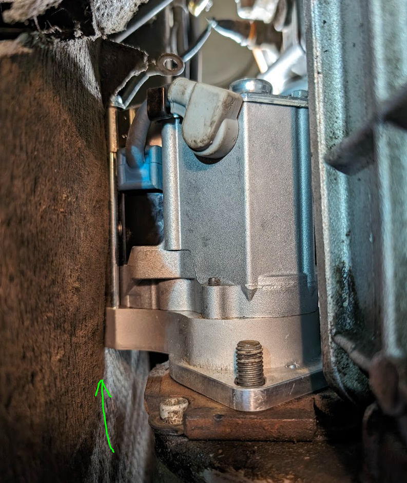

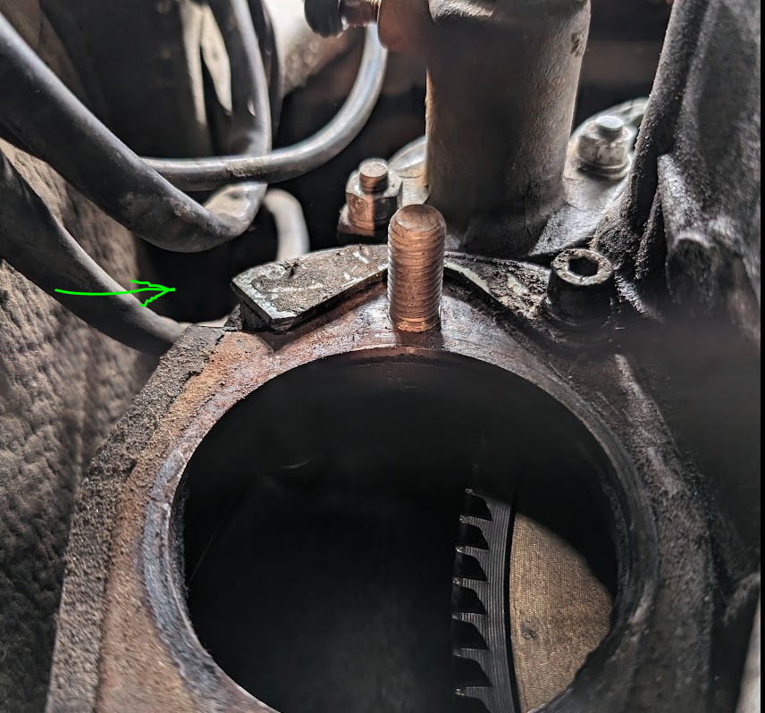

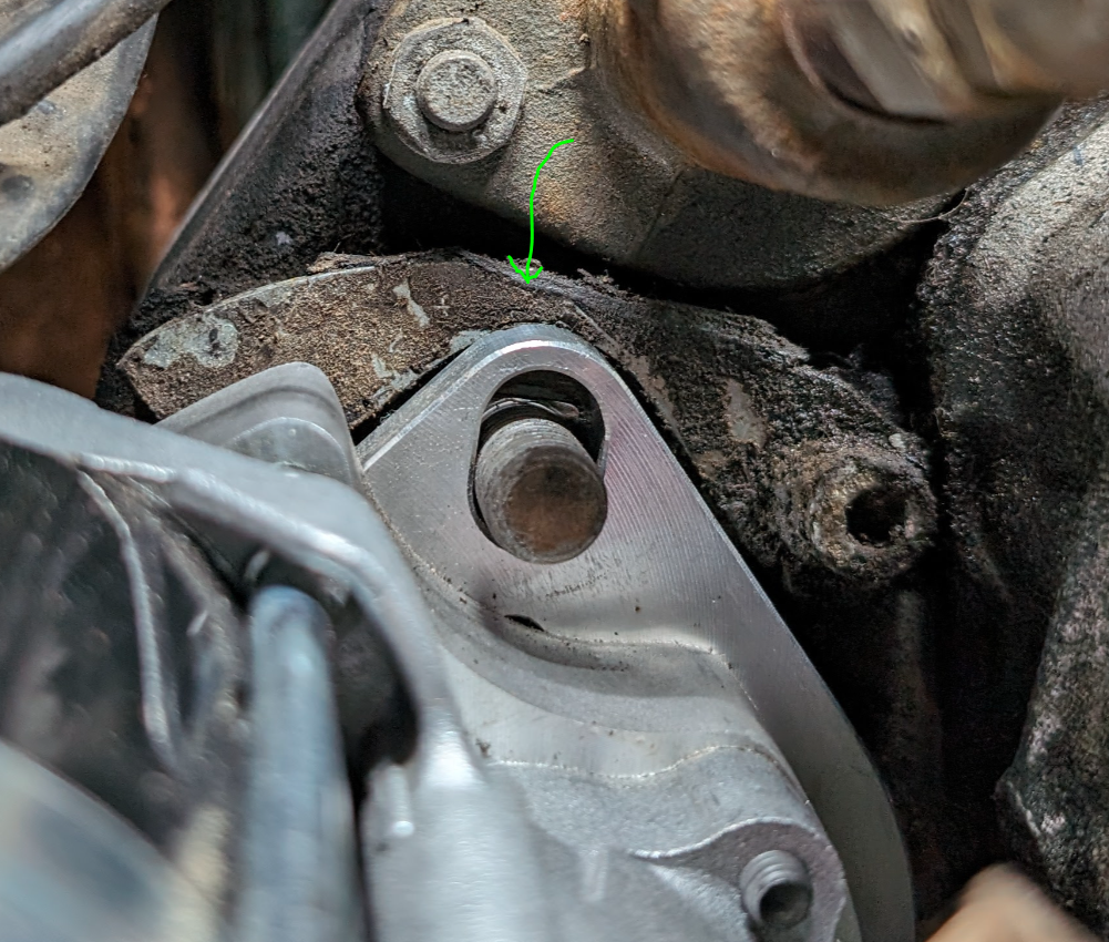

First, it turns out the starter was mis-assembled from Scott's factory, and required partial disassembly and re-clocking. Required an impact wrench to loosen the two bolts that secure the mounting flange.
Two issues remain, one small one bigger.
Small issue: The starter motor compresses the sound-deadening material. My fear is it'll rub through. Did others who use this starter also find that the motor is tight against the sidewall insulation?
Bigger issue: The upper ear of the mounting flange won't clear the keeper bracket that goes on top, across the top, of the rubber mount. Scott says that happens, and if it does one needs to loosen the keeper and move it. Well, I've loosened the inner upper bolt (socket head), and the bracket is still tight.
Any ideas on what else holds it in place? I've given it a few solid taps, and it's not moving.
Collision at the top of the ear This is the bracket that won't move. The upper right bolt is loose. See compression of sidewall insulation

Re: Starter sometimes fails to engage
The spacing between my gear reduction starter to the chassis sidewall is close but there's a wee bit of clearance.
WRT to the mounting, there are 4 bolts that hold the Starter Rubber mount and 2 that retain the "Nut plate".
My suggestion is to remove all these components, clean, and inspect for some possible debris. With all four bolts
removed that mount should come off easily unless it has taken a bond to the surface and just needs chisel whack
to release it.
Frankly, that interference looks in the neighborhood of about 2mm or so which seems a bit much for clearance
movement to accommodate. But a disassembly and clean is probably worth a try.

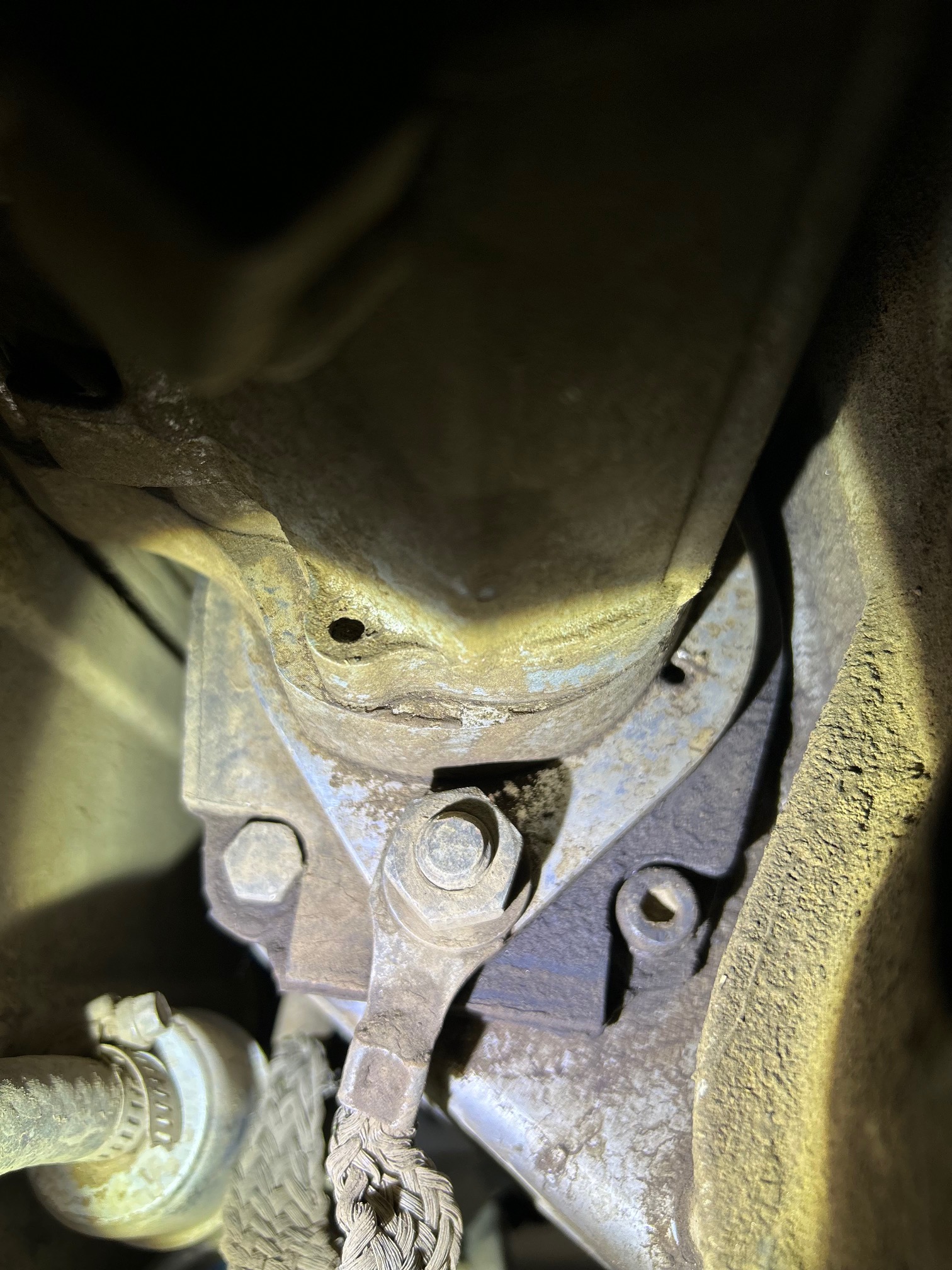

Took a pic of my ring gear. All seems fine to me - anything unusual you guys can see?
Found the problem! Previous owner installed straight- cut ring gear which every no and then fails to engage depending on heat. Ive replaced with OEM directional gear (made in Germany)
