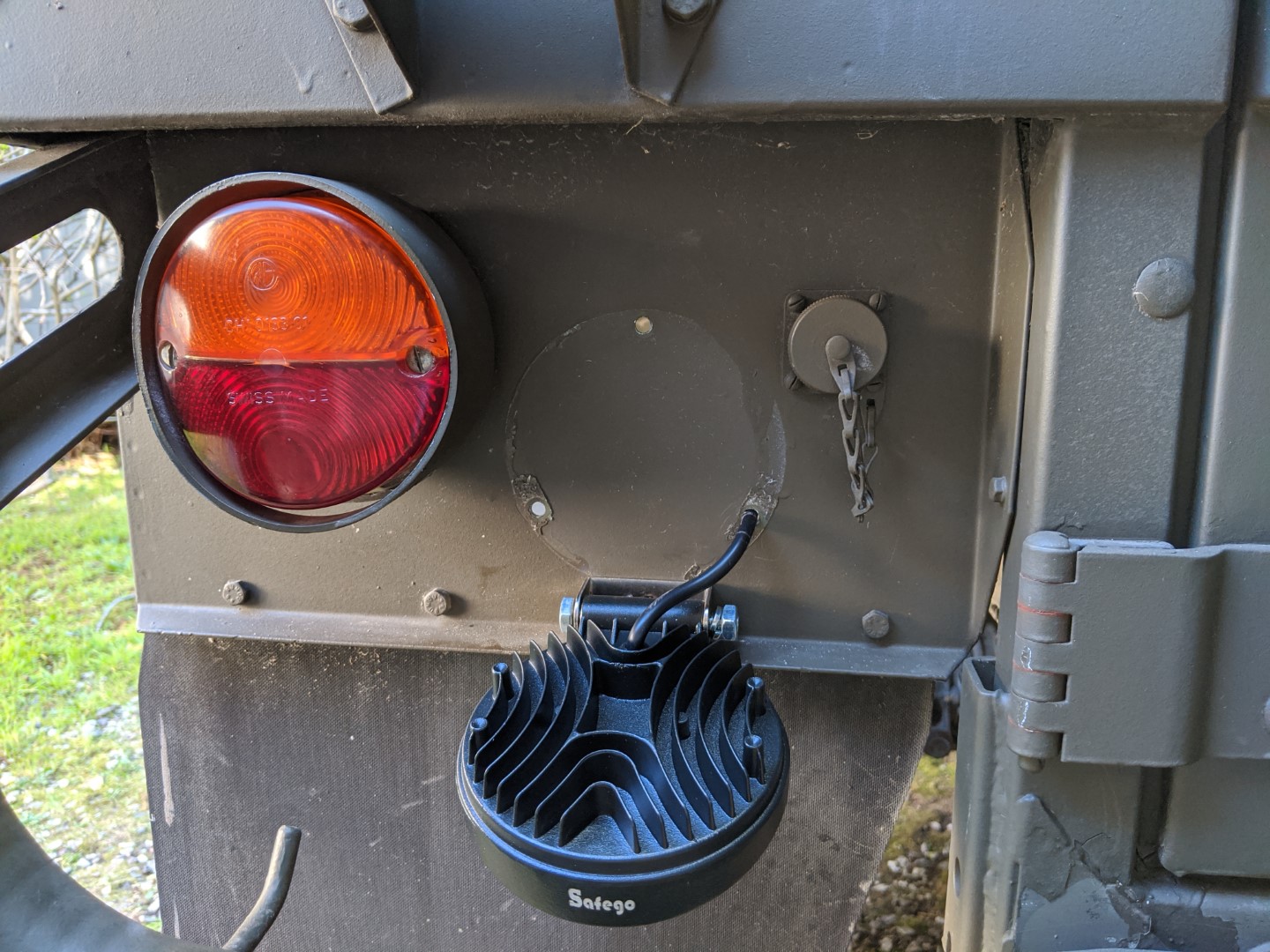

There is a cone next to where the wires go into the tail light bucket. It is welded to that panel and points towards the left rear tire. On the back side, facing traffic behind me, there is a small panel held in with 4 screws. What is this?
It’s not the trailer connection. That’s next to the trailer hitch
Now the real challenge will be getting a new wire back through the body to power those license plate lights.
Side note

No. The metal panel that the left tail light is mounted on. The cone is on the opposite side of that panel and points toward the left rear tire. It looks like ie was meant for a connection. I just don’t know what

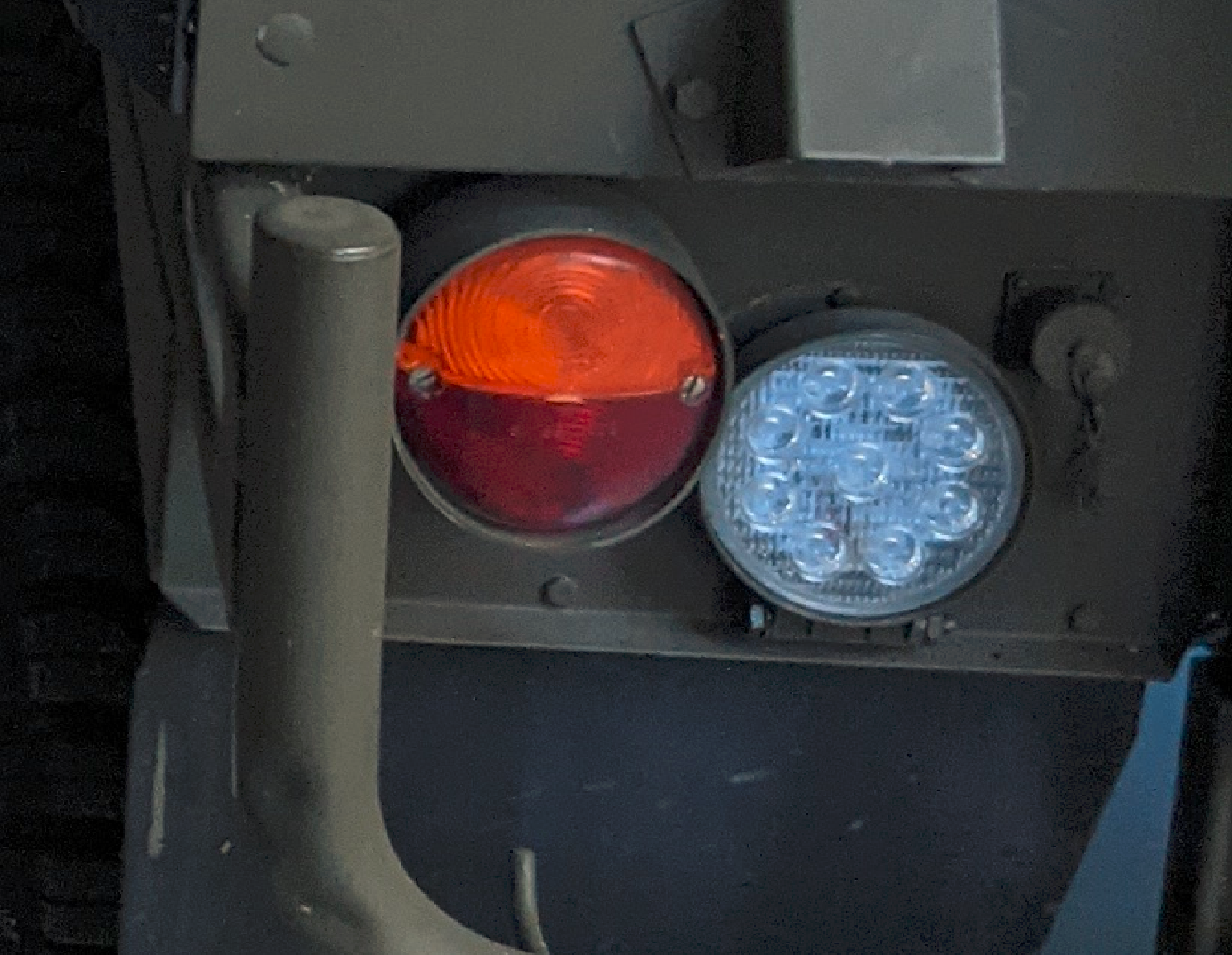

Re: Circuit #1
And a pic to show the cup you're talking about plus a view of how I removed the reflector and installed a back-up light (low and high power). I use that power connector to provide shore-power when working on the truck, or to provide 24V output.
- IMG_20200311_150753 (Large).jpg (389.26 KiB) Viewed 3794 times

Many of you probably know this but that plug was used to attach the 24v generator to the 710k for radio operation when parked. It also has a hidden fuse link in the wire to it housed in that cone.

It’s very odd. I have the large red wire that would go in there, but the connector has been removed. The wire is not connected to anything. There’s a plate held in with 4 tiny screws where the connector would be.
