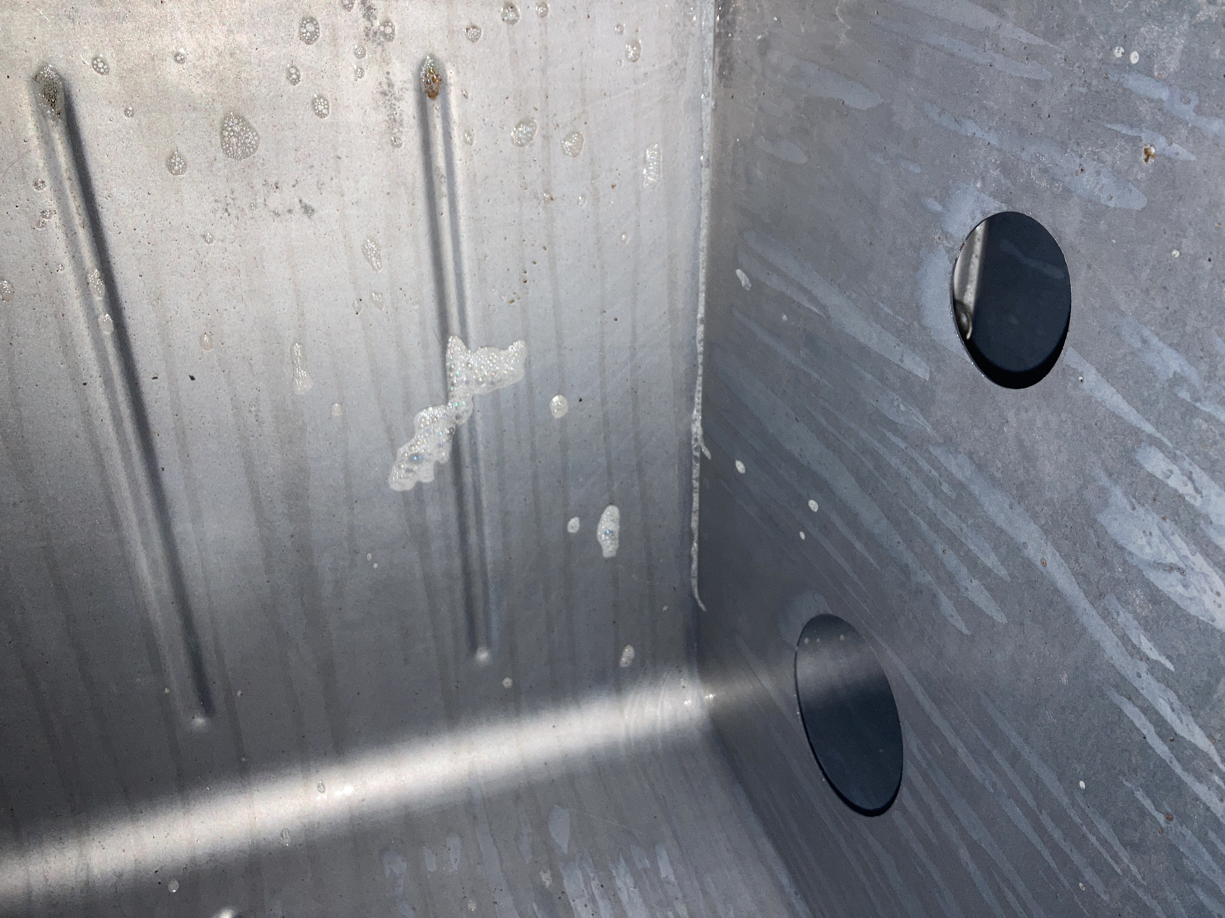

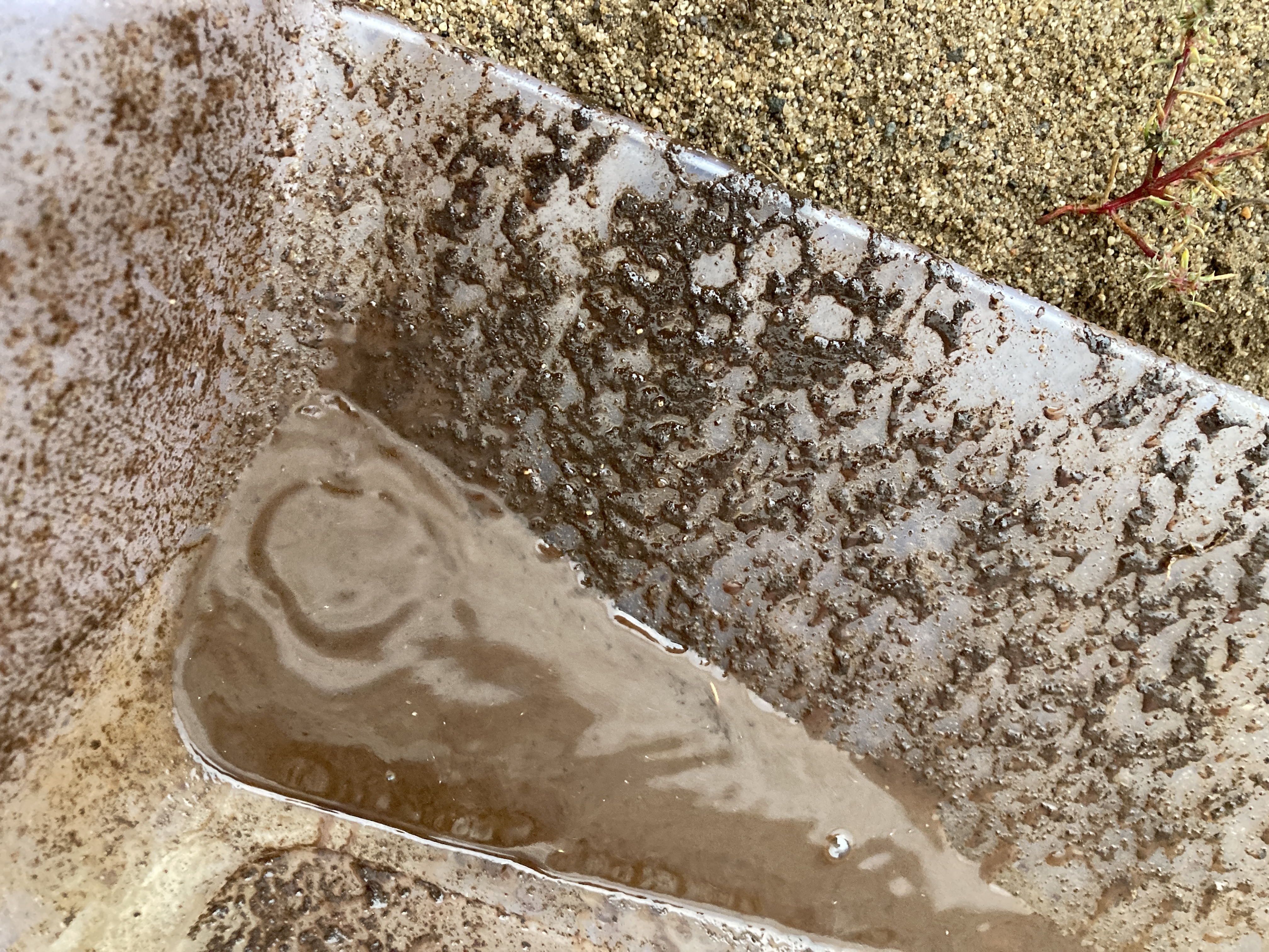

I screwed up and forgot a before pic but here's one showing the container I was pouring the vinegar into after letting it sit in the tank for two nights, which actually looks a lot like the tank did.
I put in two gallons of the extra strong commercial vinegar like you buy at Home Depot. I would rotate the tank and let it sit for a half day or more in each position. I also treated it with a gallon of strong degreaser to help wash out everything else, which there was a lot of.
Then I took this after several rinses with a garden hose.... it worked amazingly well as you can see! There was rust all over that metal before. I did one more treatment with the "POR15 Metal Prep" that I use for winch parts (I recycled that, which you can do many times). This stuff leaves a zinc phosphate coating to help prevent flash rusting. I immediately put my heat gun in the fill hole and dried it out fully for about 30 minutes. Ideally I'd be able to coat the entire tank with sealer but the price on that stuff is really high since I'd probably need two quarts. (one quart treats about a 25g tank) The diesel fuel and my NV climate should keep it from rusting again.
