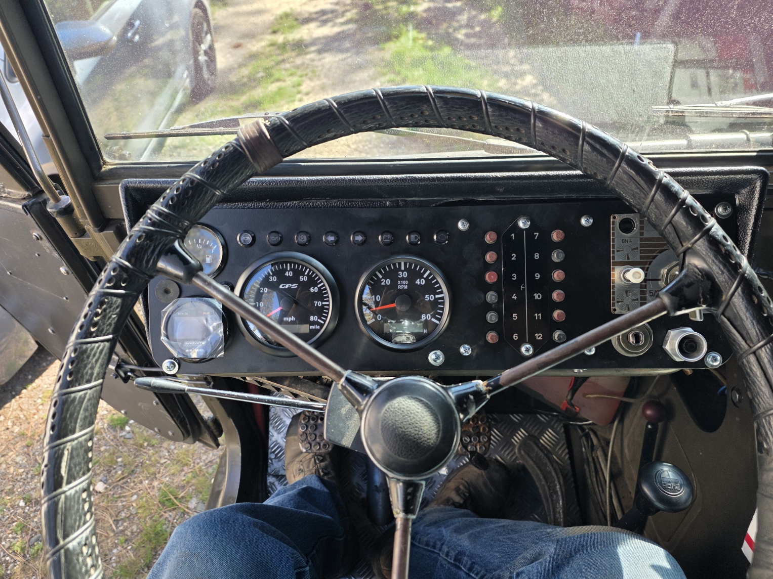

got my dash built and installed this weekend
you could go efi with injectors in intake the manifolds, and fuel shut off to carbs. just a thought.
I plant to go efi with a low pressure turbo.
remote mount oil cooler with electric fan. That will increase oil, and cylinder cooling.
