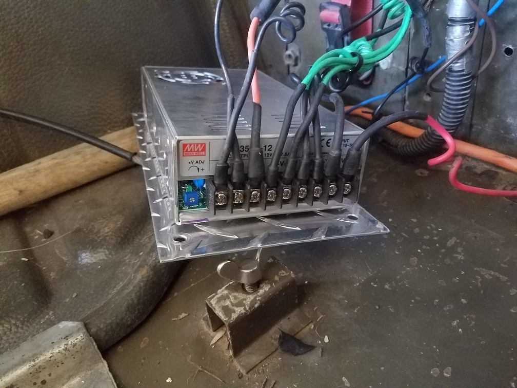

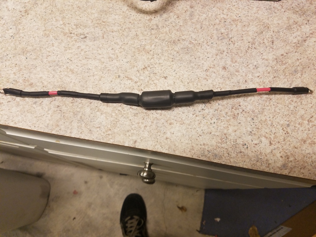

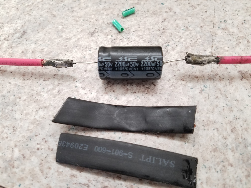

I have finally gotten around to switching out my converter. Ended going with the Mean Well converter, so far no complaints. FYI, I believe they make a backing plate for the converter but mine did not come with one, didn't know, so I made one out of diamond plate. The converter sits off the plate for air flow. I matched the plate to what was there previous and didn't have to drill any additional holes.
I made the decision to go ahead and upgrade to the SSI system while I was in there along with two new Yellow Top batteries. I thought I would add some pictures with the install. Jimm391730 was very kind in helping me work out some details and he also recommended a capacitor to help with any sudden power draws which I had not heard of, but I am not one to second guess the advice. No issue with the truck starting with this added. I kind of got crazy with the shrink wrap but it will keep the dust out and hold everything together
So far, so good. All the previous 12V equipment works great and the truck runs really well. Bonus on the clean look of the engine without all the wires going over the fan. Overall both were pretty easy installs.

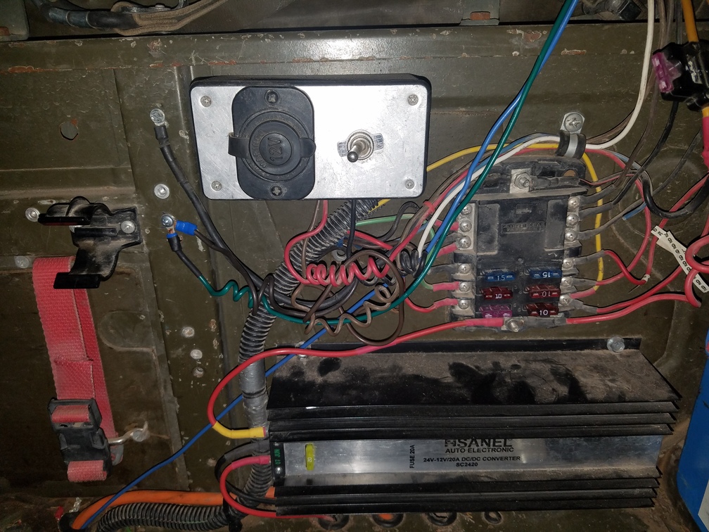

The biggest killer of some of these converters are the cooling fans. Just look at Texas710's PIX of the dust
on that Sanel converter.
If your converter requires a fan for cooling it is forcing that dirty air right into the fan bearings, some of these
fans are open bearing and will eventually fail. If you run the trails your going to be better off with a hermetically
sealed converter that has a large heat sink and convection cooled rather than forced air. The converter I use
for my EFI is just that, it is physically large due to the heatsink. All my mission critical converters are fanless.
If you run these guys up to the edge they are more likely to exhibit poor regulation first, that said it's a good
idea to derate and run at no higher than 70% the rated output.
