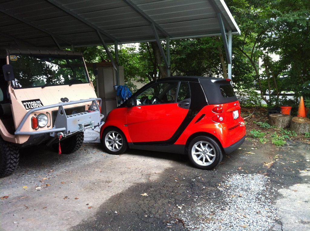

I need to pick up some synthetic lines. Way too much weight up front.
- My current guard and winch set up. The SMART car is the fiance's (Just sayin)
- 279361_10151187248221690_1409221000_o.jpg (410.5 KiB) Viewed 5553 times

Re: Winch Info
That guard (behind the chair) was one of my 2nd generation Winch guards. I stopped mounting them over the bumperettes for 3rd generation and beyond. I found under "Heavy Winching" the guard would bend and pull at the bumperettes because they weren't as sturdy as the body mounts.
